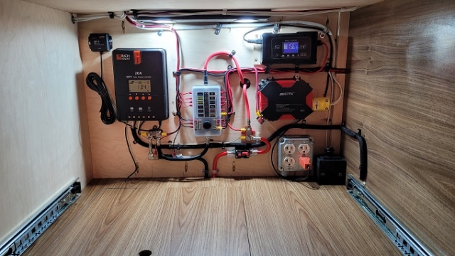

Postby Onajourney » Fri Dec 15, 2023 10:24 am
The one big thing I don't see is the 120V battery charger. Make sure you wire the 12v side before the main shut off so when you shut the main off, it will still charge when you plug into shore power. Same goes for the solar charger. I don't have a wiring diagram of what I did but this is it what it looks like.

Postby bdosborn » Sat Dec 16, 2023 1:59 pm
Tom&Shelly wrote:There aren't a lot of things these days that only require the energy in a teardrop size battery that are just made to run off of 120 vac. Since there is a conversion loss in the inverter it's usually more efficient to buy the 12 volt version.
I still run everything I can at 12V as it's always the most efficient. I consider the inverter in the van to be a total luxury; it's awesome for running the Keurig, induction cook top and a microwave. We even use it to for the water heater. BUT, all our essential services are 12V: fridge, CPAP, lights, diesel heater, TV, etc... We carry a small butane stove to back up the induction stove top if the battery is low. Everything else the inverter runs we can do without in a pinch. I wouldn't have added an inverter in the van at all except I wanted to try the all electric approach, the trailer that has propane and I haven't used the small inverter in it for about 10 years.

Postby italianub » Thu Jan 25, 2024 9:26 pm
Alright, new updated diagram, thoughts?
I might put a 120v battery charger in there as well for when I have shore power, but I already have the charger so I can just put it in if I decide to use it. Not pictured is the shore power plug that I will install, but not connected to anything except a power strip in the galley.
You guys are awesome. I start my build in 2 weeks!

Postby tony.latham » Sat Jan 27, 2024 11:02 am
I don't know which battery monitor you have but my AiLi meter (that I really like) shows juice going in and out. So the shunt should also be downstream of the solar controller. Just run your negative to the negative bus bar.

Postby bdosborn » Sun Jan 28, 2024 11:09 am
Typically the master switch only connects to the positive side of the battery. No need to switch the negative. Most people are putting a double pole circuit breaker between the solar panel and the controller. This breaker DOES switch the positive and negative wires.
