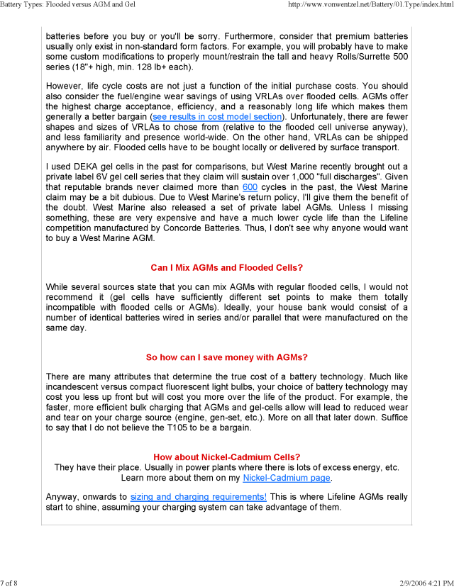

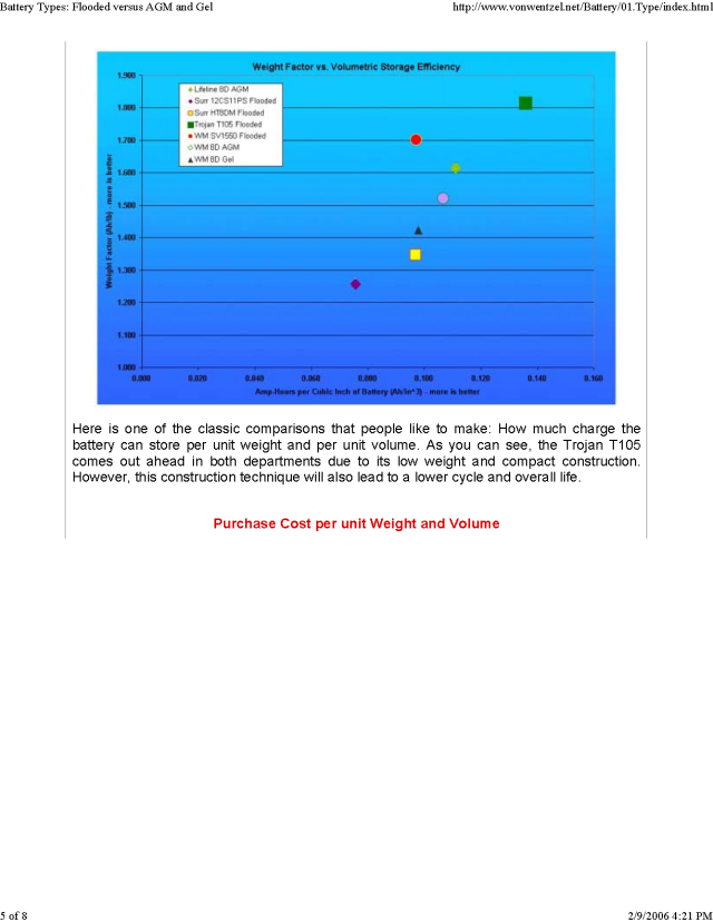

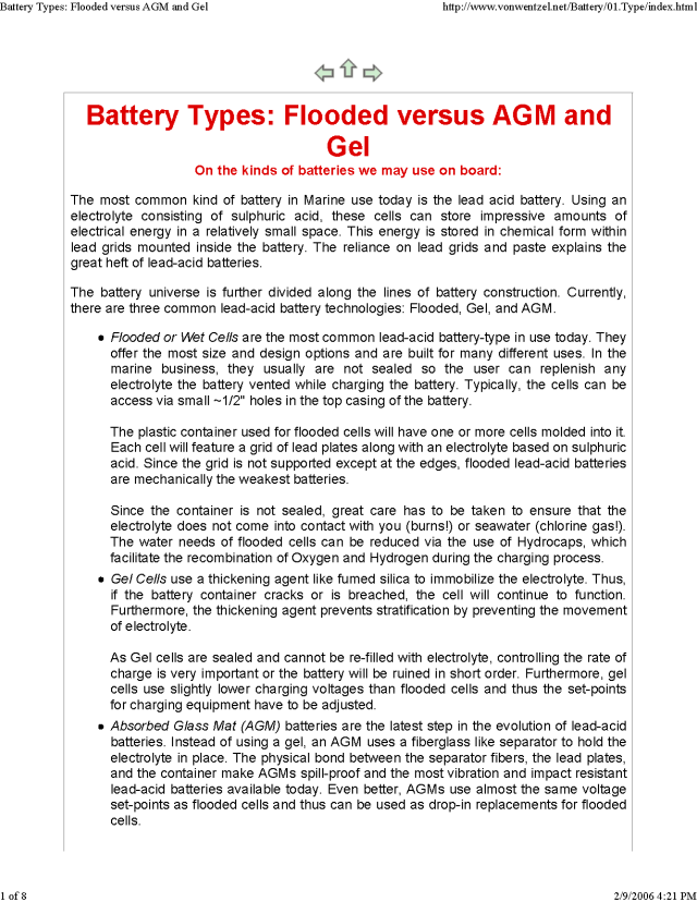

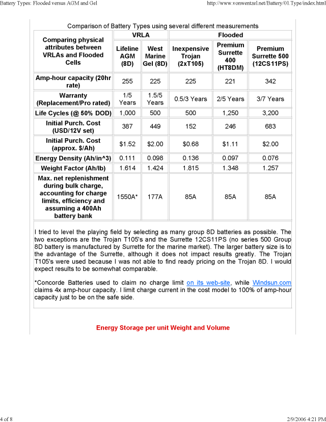

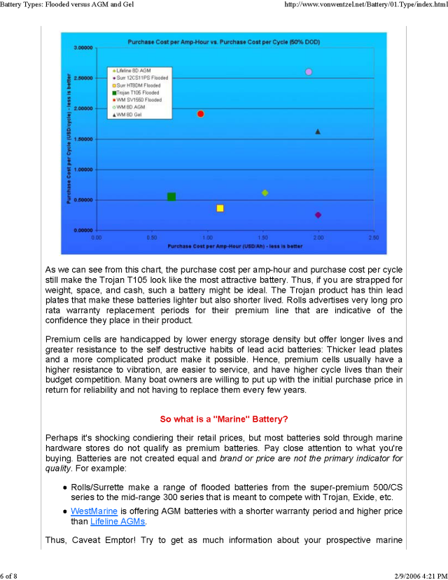

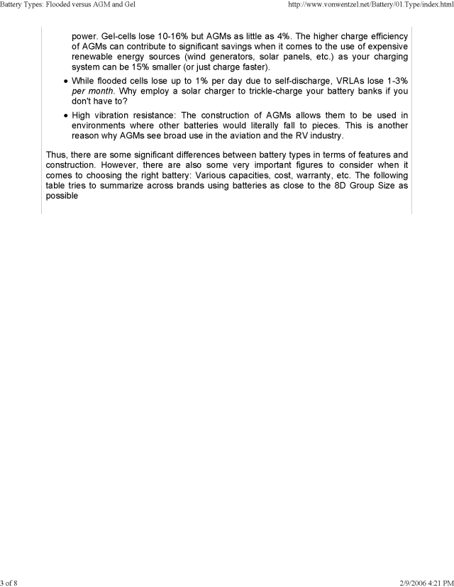

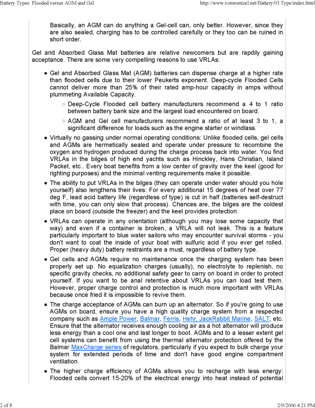

Postby Guy » Thu Feb 09, 2006 4:33 pm
Here is and article comparing and discussing all major battery types
Edit: All fixed up! Mike....

Mike shrink please
Postby Guy » Thu Feb 09, 2006 5:03 pm
Dear Mike or anyone else,
I was having trouble shrinking those png files to fit the page.
Please fix if possible

Postby bdosborn » Thu Feb 09, 2006 10:41 pm
Mike,
This site has a good comparison of cost versus life for batteries. It also explains the difference between the different types. Its as close to your chart as I think you'll find.
http://gerry.vanagon.com/files/technica ... attery.txt
For me, being the cheap SOB I am, I went wih the lowest lifetime cost/AH. FWIW, the warranty for batteries in large UPSs we design around is 5 years for VRLA and 10 years for flooded cell. Neither type will ever last as long as the warranty under normal use (hence the typical pro rated warranty ) but it was a good indicator to me that a flooded cell would last longer.

Postby cracker39 » Fri Feb 10, 2006 9:14 am
Bruce,
That article sas the most information about batteries that I've read yet. It covered nearly everything and cleared up the ratings for batteries, converting all of the CCAs, MCAs, SHs, RCs into math that I can understand. It touched on charging, but I wonder why it didn't discuss how multi-stage chargers take care of the correct charging and maintenance problem. I've already learned how that's done, but, for someone who didn't know, it would have been helpful if the article covered it.
The bottom line is that for my camping style, which will usually be with shore power, and hardly ever for more than a 2-3 days and nights at a time, probably no more than 6-8 outings a year, the LA battery will meet my needs...Low initial cost and providing the amps I will need for an outing. If I ever do have an extened outing, It will most likely be where I am traveling and staying at campgrounds with shore power.
I'm not a cheap SOB (I'm just FRUGAL...hmmm...that is being a cheap SOB isn't it?). So, I will buy a group 27 LA battery. Adding a B&D 6/4/2 amp 3-stage charger (from WM at 28 bucks), I'll have a relatively inexpensive 12V system that will provide all of the power I'll need.
