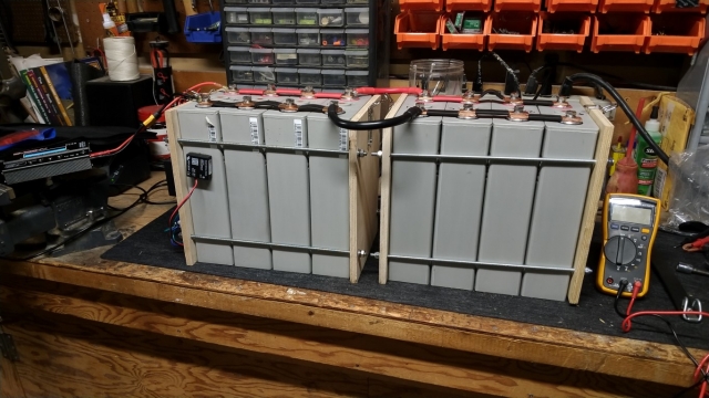

I put my batteries together in two blocks, just so I could still lift them. Even though they don't have lead in them four larger LiFePO4 cells still weighs around 40#. I used some baltic birch plywood that was laying around the garage to put them in compression, with the current price of lumber I wish I'd used something cheaper! I'm top balancing eight 180 a-hr cells in this pic:

bdosborn wrote:I put my batteries together in two blocks, just so I could still lift them. Even though they don't have lead in them four larger LiFePO4 cells still weighs around 40#. I used some baltic birch plywood that was laying around the garage to put them in compression, with the current price of lumber I wish I'd used something cheaper! I'm top balancing eight 180 a-hr cells in this pic:
Looks like a good plan for you to make 2 separate modules. How many Ah are those cells? They look much bigger than the ones I got. All 8 of mine together are about 40 lbs.
I won’t be able to parallel and top balance mine inside the box I’m making because of the battery arrangement. I’ll need to put all 8 cells in a row on the benchtop for that. But starting with the first capacity test discharge, they will be compressed inside the box.

Postby bdosborn » Mon Jun 14, 2021 2:14 pm
lfhoward wrote:They look much bigger than the ones I got.
Yeah, I hear that all the time. They are 180 a-hr CALB cells.
