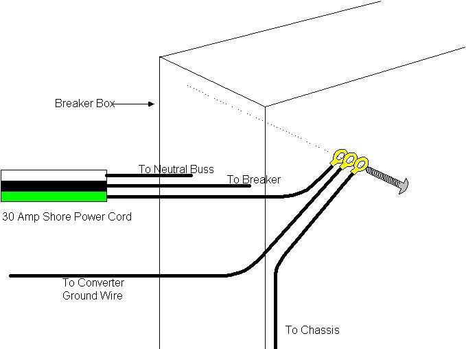

Postby cracker39 » Thu Mar 30, 2006 11:45 am
Thanks for the info. I already have GFCI outlets for my trailer. I don't really see the need to buy a bus for 3 wires as there will only be one breaker in the box. I'll drill through the side of the box and connect a wire to to my box and use it to connect to my incoming ground, the frame, and outgoing ground wire to the converter by twisting and soldering them together and covering with a wire nut.

Postby TD4FREEW/CTD » Sat Apr 01, 2006 2:39 am
cracker39 wrote:Thanks for the info. I already have GFCI outlets for my trailer. I don't really see the need to buy a bus for 3 wires as there will only be one breaker in the box. I'll drill through the side of the box and connect a wire to to my box and use it to connect to my incoming ground, the frame, and outgoing ground wire to the converter by twisting and soldering them together and covering with a wire nut.
I do want to get a 4-fuse block for my 12V sub panel, as the converter only has 3 12V fuses for appliances and I want to run two outlets and my lights on separate fuses. I can easily make a 12V ground buss with a piece of metal strap and small bolts and nuts.
what did you plan on using to bond the ground to the box/trailer chassis? maybe an eyelet splice or somthin'? always helps to remove paint at the point of bonding as well.

Postby cracker39 » Sat Apr 01, 2006 6:19 am
TD4FREEW/CTD wrote:what did you plan on using to bond the ground to the box/trailer chassis? maybe an eyelet splice or somthin'? always helps to remove paint at the point of bonding as well.
My shore cable is flexible, twisted wire. I have some solid 10ga 3+ground left over from installing a 220V outlet for the welder that I could use, but I think it may be too stiff to work with in tight places, so I may buy a length of 10ga flexible cable to run from the main breaker box to the converter. I will probably put a crimped "eyelet" on the end of the shore cable ground wire, the ground wire going to the converter, and one going to the chassis and connect all three eyelets to the box with one of the mounting screws, making sure I scrape the paint off the box where the screw contacts it to get a good connection.
The chassis ground wire will connect to one of the bolts holding the tongue box to the frame, again making sure I have scraped down to bare metal where the bolt connects to the frame.
I'll run a ground wire from my battery's negative post to the frame the same way as the 110VAC ground, using a tongue box to frame bolt on the battery side of the tongue box.
