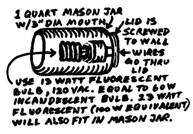

I was trying to figure out a good way to be objective about light output. Just for the fun of it, I set my photographic light meter at 200 ASA and adjusted it to measure the light falling on it. Then I took a tape measure and put the head of the light meter 15 inches away from the light source.
Here are the EV (Exposure Value) readings (taken at night with the light listed as the only light source):
EV 13.3 13 watt fluorescent bulb, 120 VAC, with power from 12 VDC to 120 VAC inverter. 120 VAC bulb, 13 watts, 0.1 amps.
EV 13.3 12VDC dome light with #1141 incandescent bulb, with power from 12VDC automobile battery. 12.8 VDC bulb, 18.4 watts, 1.44 amps.
EV 13.6 60-watt clear incandescent bulb, 120 VAC, 0.5 amps.
EV 13.6 15-LED flashlight, 2” reflector, 6VDC, flashlight batteries, measured in the cone of brightest light. Watts, amps unknown, but probably the least of all. For 18 LED bulb in a dome lite, estimate 12 VDC, 1 watt, 0.083 amps.
The first three lights are all about the same brightness, but the amperage needed to run them varies considerably. The 13-watt fluorescent is most efficient of the three.
I have to fudge on the LEDs, because all I had was a flashlight. I took the light reading in the brightest reflected light. Would I get as much light from 15 LEDs in a dome light fixture? I doubt it.
So here are my thoughts.
For dry camping, onboard trailer battery only, I'll take the 13-watt fluorescent bulb. With the low amperage draw, my battery will last longer. (I realize there is an amperage penalty for using the inverter.) I don't see the color rendition problems you mentioned, and I use these bulbs in my home.
For shore power with a battery charge being maintained, I'll take the 12-volt bulb in the dome light.
The LEDs appear to use the lowest amperage, with 18 LEDS about 1.2 times as efficient as the fluorescent bulb. I don't know if they produce as much light because I don't have one to check. But at $18 per bulb, versus $2 per fluorescent bulb, they are expensive alternatives.
