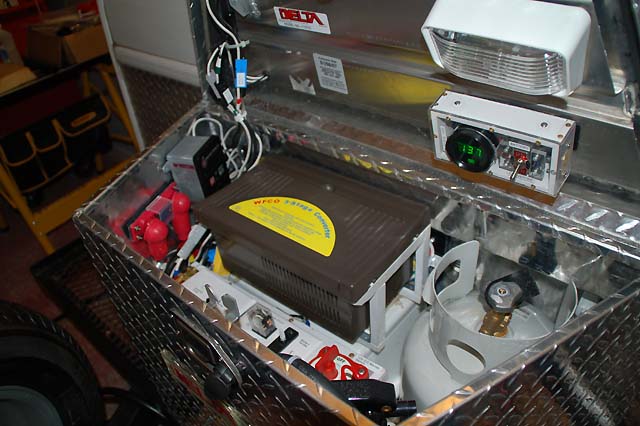

Postby wlooper89 » Mon Jul 28, 2008 5:02 pm
bobhenry wrote: Bill my ac circuits are not grounded to the chassis they ground directly back to the shore power source ONLY. I have accidently shorter out wires while wiring a couple circuits hot and the GFCI that is the 1st load after entering my trailer tripped as well as the source gfi
Sorry I misinterpreted your previous note. Now I understand, and your GFCI's did their job perfectly. Earlier I spoke again with the salesperson at North Shore Safety with whom I had placed my new GFCI order. He then talked with their engineer. They said that one side of A/C could short to the ungrounded trailer chassis and nothing would happen, but if something or someone completes a path to ground then the GFCI would trip if the short is downstream (load side) of the GFCI. My example was a person standing on wet ground touching the chassis. He said the trip happens in milliseconds and should prevent harm to the person. This confirmed for me the electrical setup I wanted after hearing what you and others have done.
The photo below shows my electrical compartment attached to the trailer frame. My new GFCI connects directly to the shore power inlet and is mounted on the pasenger side of this box. I now realize that I could have a short circuit already, and not know about it, between A/C primary or common and this metal compartment. That will be easy to check now with a circuit tester. I may do that periodically since the GFCI at the shore power inlet will not trip unless something or someone completes the path to ground.
You and others in this topic have been very helpful to me. Many thanks!
Bill :applause:

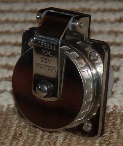

Postby wlooper89 » Thu Jul 31, 2008 1:24 pm
Returning to the subject of A/C grounding, I painstakingly arrived at a decision not to ground A/C to the trailer chassis and ground A/C only to shore power ground. This was after reading a number of posts on this subject including recent posts by Bob and Dale.
While checking things out with an ohmmeter/circuit tester I found to my dismay that my metal shore power inlet itself grounded A/C internally to the inlet housing. The inlet attaches to my metal electrical compartment which in turn attaches to the trailer frame. So my A/C ground has been connected to the trailer chassis all along. Then I noticed the word "Grounding" stamped right on the front of the inlet. :o
Fortunately I was able to partially disassemble the inlet and remove the grounding strap.
Bill

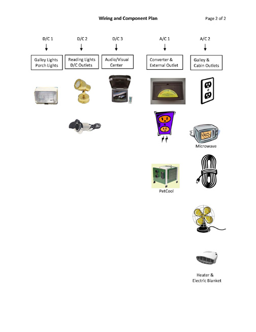

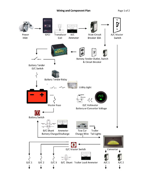

Postby wlooper89 » Tue Sep 02, 2008 11:39 am
My wiring plans appear below. Although I found some different component pictures, I owe a lot of the result to Joanne. I used electrical symbols for fuses and some of the switches and the other items are shown as pictures, some of them my own components.
One item that may be a bit unusual is the Battery Tender relay. I did not want the Battery Tender to try to charge the battery at the same time as the converter, so the relay prevents that if I should forget and position switches to use both chargers.
This is more of a flow chart than wiring diagram and the exact wiring is not shown. The first page follows the flow to A/C and D/C buses, and the second page shows some of the items that are in use now or might later be used on the buses. The audio/visual system is not yet in place and the PetCool is on hand but not installed.
I would be happy to try to answer any questions about my wiring, although I am far from being an electrical expert. In the past questions and comments have helped me make improvements.
Thanks, Bill
Page 1
Page 2

Postby sportsta05 » Fri Sep 05, 2008 1:07 pm
Hi, I am new to the forum and hae a quick question. What type of wire is the best to use? I know stranded wire is prefered to a solid wire. I have seen RVI and GXL wires on some websites. Does anyone have a preference? Thanks for all the other info. I have really got a grasp on most of this wiring stuff.
Thanks again
Kyle
sportsta05
Posts: 4
Joined: Thu Sep 04, 2008 11:24 pm
Location: FT. BLISS
Postby wlooper89 » Fri Sep 05, 2008 3:39 pm
My A/C wire is flexible 10-3 from shore power to my converter. Then it splits into 2 cables that are flexible 12-3. Both are CSA type rated 300 volts and 105 deg. C. Lowe's had the flexible 12-3 wire and I ordered the flexible 10-3 from an arc welding suppy company. It is meant to be power cord for a welder. In some cases this cable was too bulky for where I needed to use it and I removed the outer jacket, just using the black, white and green insulated wires from inside. All of the #10 A/C wire is inside my electrical compartment on the trailer tongue, so I did not need a lot of it.
On the D/C side I used flexible #10 electric brake wire from an RV supply company. It has an outer jacket with insulated black and white wires inside. The rating type is not stamped on the cable, just 105 deg. C. I think the D/C wire is rated for a much lower voltage. Less than 100 V so I would not want to use that with A/C. I also ordered some #10 D/C wire from a solar power supply place, but the wires inside the cable were red and black instead of white and black. I decided to just use the white and black cable which is most common for an RV. #12 flexible D/C hookup wire connects my D/C lights and outlets from a junction box in the trailer.
I hope there is something in this post that helps and am sure a lot of others in this group are more knowledgeable about wiring than myself.
Bill
