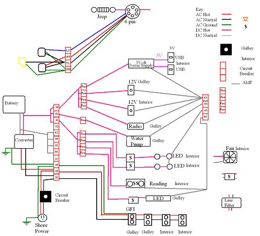

Postby Forrest747 » Fri Sep 04, 2009 1:18 am
Here are my plans not sure about my fuse sizes yets getting some good advice from reading post. Thank you guys

Postby StealthDave » Mon Sep 07, 2009 7:10 am
OK, I admit to basic idiocy here. I looked through the post but couldn't find the info I was seeking. Its probably staring right at me.lol. Here is my basic question regarding the diagrams on page 7:
Can you use regular single pole breakers from home depot/lowes for all breaker applications, or do you need specific breakers for 12 volt apps and specific 110/120 volt breakers?
Thank you,
Dave
StealthDave
Posts: 13
Joined: Wed Jul 15, 2009 8:25 pm
Postby CPlater » Mon Sep 07, 2009 7:30 am
StealthDave wrote:Can you use regular single pole breakers from home depot/lowes for all breaker applications, or do you need specific breakers for 12 volt apps and specific 110/120 volt breakers?
No. AC and DC circuit breakers are different. Typically DC breakers are little rectangular metal cans with a couple of studs protruding from the top and there is usually no reset button or switch.

Postby Shadow Catcher » Mon Sep 07, 2009 7:33 am
You need automotive type fuses for the 12 volt and regular Lowe's circuit breakers for 110. Both types of holders are easy to find. Progressive Dynamics makes a converter 110 and 12V circuit distribution center
www.progressivedyn.com/all_in_one_pd4300.html
This give an idea of how this could be fabed up, or just use theirs.
Posts: 5745
Images: 214
Postby wlooper89 » Mon Sep 07, 2009 11:03 am
Shadow Catcher wrote:You need automotive type fuses for the 12 volt and regular Lowe's circuit breakers for 110. Both types of holders are easy to find. Progressive Dynamics makes a converter 110 and 12V circuit distribution center
I agree. The Progressive model looks good and has more circuits. For a smaller and less expensive one I am using this.
http://www.bestconverter.com/WFCO-8725- ... _p_50.html
There are fuses for 3 DC circuits plus battery charge connection and reverse polarity protection. The battery charge wire feeds battery power through to the 3 DC circuits if there is no AC hookup.
There are two slots for AC circuit breakers.
Bill

Postby BC Dave » Tue Nov 03, 2009 12:16 pm
toypusher wrote:I believe, with much assistance from Bruce, that the following is what should be safe and cover exactly what I want in my tear.
and a blowup of the Circuit Breakers
And finally, what Joanne's original configuration, using the tow vehicle for charging and having NO 120VAC.
Sure hope that these are correct now and that everyone can get some use from them.
Many thanks to Joanne for the original drawings and especially to Bruce for all the technical advise.
:applause: :applause: :applause: :applause:
Kerry
Excellent! Thanks! This helps clarify. You may want to add grounding the AC bare or green to the trailer frame (did you do that?).
Cheers Dave

Postby absolutsnwbrdr » Tue Jan 26, 2010 6:08 pm
toypusher wrote:And finally, what Joanne's original configuration, using the tow vehicle for charging and having NO 120VAC.
Kerry
Using this 12vdc only setup, would I need something between the tow battery and trailer battery? I was just reading another post about a Sure Power 1314 battery sererator?
Zach

Postby Redhawk10 » Mon Mar 29, 2010 10:43 am
Hi
I was looking at your wiring plans and was wondering if you had already put it into use and how it worked out for you. I'm trying to set up the electrical for the TD i'm building. :thinking:

Postby jofa » Fri Sep 30, 2011 12:29 pm
Just made this scheme in Excel with Office drawing tool so anyone can download and adjust it to it's needs. ...just draw the lines. This is what I would like to instal, but my electricity knowledge is poor.
would like to pre-wire for solar but dont know where to go with it.
If you check my sheme you will see what i mean. Also, have no idea if inverter setup is right!?
does this scheme make any sence at all!?
http://www.mediafire.com/?bdp594sj489bjfj
jofa
Posts: 27
Joined: Thu Sep 29, 2011 2:17 pm
Location: Zagreb (Croatia)
Postby absolutsnwbrdr » Tue Oct 04, 2011 8:21 am
jofa wrote:Just made this scheme in Excel with Office drawing tool so anyone can download and adjust it to it's needs. ...just draw the lines. This is what I would like to instal, but my electricity knowledge is poor.
Looks pretty good Jofa. The wires coming from the Solar Charge Controller would just connect to your battery.
As for the power inverter, you just reminded that I forgot to include one on my new wiring diagram. On my trailer now, I just use a small 400W power inverter that hooks directly to the car battery, and then I plug the "shore power" into the inverter, which takes the AC throughout the trailer.
Here is my diagram....
http://tnttt.com/viewto ... 155#871155
