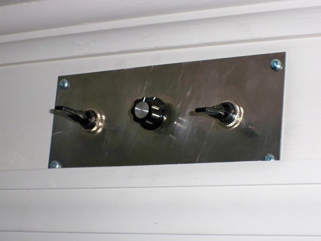

I used a PWM on my fan and it is great. Because it pulses 12v to the fan it does not run hot. I tried it for several hours and felt the fan. The motor was still cool to the touch with the air flowing over it. It will slow down plenty more than I think I will ever want. I did some elaborate wiring on mine with a revesing switch for the opening and another one for the fan direction. It works great now. :D
The center knob is of coarse the Pulse Width Modulator.
Hope this helps
