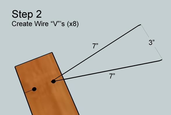

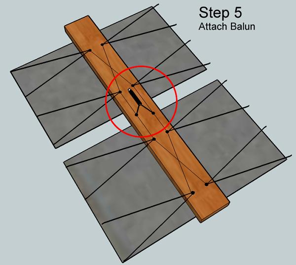

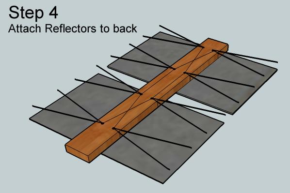

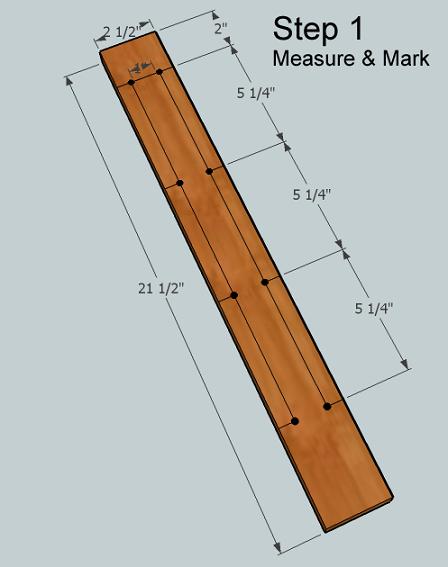

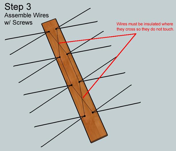

At our Whitewater Memorial gathering was this past weekend 4 of us brought our "Redneck" antennas. This little $3.00 home project takes about 20 minutes to build.
Oh yeah ....The outcome ...........
Scott 32 channels Me 34, Kurt 30 some ?? Scuba 34.
We were 40 miles from Cincinatti and about the same from Dayton Ohio.
Wife and I cut the cabel / sattelite connection 3 years ago and I built this little antenna in January of 09 have 2 set up in the house for our home viewing and they work great.
I'll be adding pictures of the build instructions in my albmu later today for those that may be interested.

I built this exact antenna this morning with material I had on hand in the garage. I mounted it in the back yard on a farm type fence post. I have not installed any reflectors and I did not aim it any more than just a general siting towards the southwest which is where the local towers are located (Cedar Hill, TX.)
According to Google maps it is about 34 miles from my house to Cedar Hill. I was amazed at the results from this very small home built antenna.
Antenna mounted in back yard.
Channel scan showing 67 channels found
Local CBS affiliate - sample picture.
