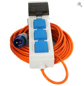

Postby Vindi_andy » Mon Feb 11, 2013 10:01 am
Doesn't get much simpler than this. OK admittedly its UK but thats my shore power hook up

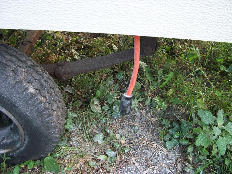

Postby bobhenry » Mon May 13, 2013 10:32 am
Had to do some lookin' to find a picture of my power port inlet :lol: :lol:
This is Rip VanWinkles power inlet have one just like it on Chubby and the Barn.
