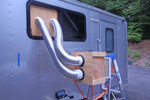

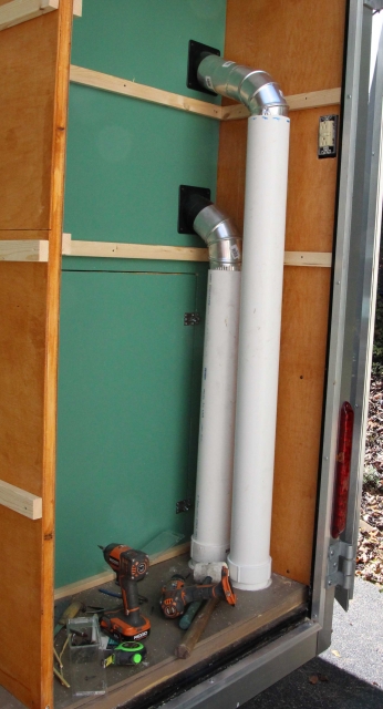

I am not sure what a "long length" is and just maybe I am in that category. But my original trials last August produced good, unscientific (meaning no data obtained other then temperatures) results. I have since added a few more feet and maybe another bend or two in the rear installation. I cannot wait for the first real trial of this new design.
Final setup with first test.
Final set up with AC unit to be under trailer.
Bob
lrrowe

And Bob, I like the 6" (I assume) drain pipes for ducting! I wish I had thought of doing it that way last year before I actually built in my ducting system. Would have made life a lot easier. :D

Postby lrrowe » Wed Mar 16, 2016 9:26 am
Thanks Dave,
I hope these 6" pipes work. And if I see flow issues, I will look into fans as you and others have done. I do not have to worry too much about the inside noise given where the pipes are.
