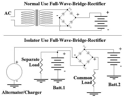

Dale M. wrote:One does not even need to bridge rectifier to charge two batteries, two simple diodes will do the same thing.... Remember voltage/current only flows one way through a diode.... Think if it as a check valve to in a water system or a air system...
http://www.the12volt.com/diodes/diodes.asp
Dale

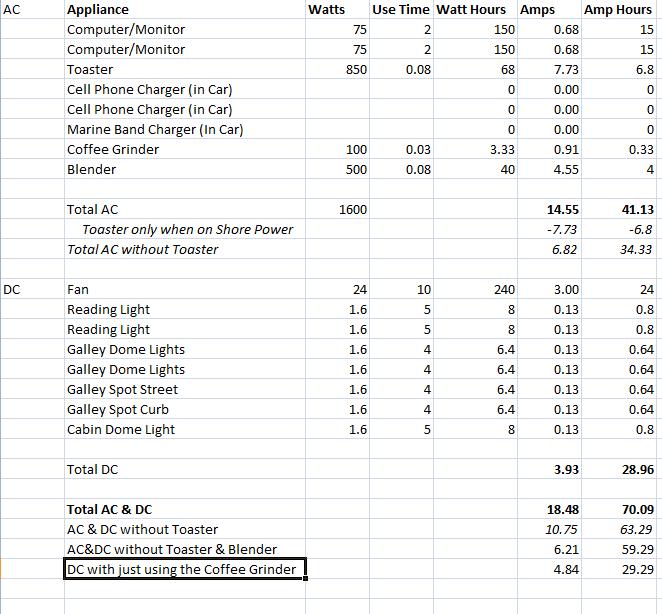

bdosborn wrote:P.S. Your spreadsheet is wrong. You can't add AC and DC amps together directly as they are at different voltages....
VermonTear wrote: Ahhh... so that's the load. I'll use 10 amps as the load.(How did you measure the battery charging current? Is that something you can do with a little hand held voltage meter?). I'll run a #8 if I can run it through my 7 pin plug, otherwise I'll run a # 10 cause I'm sure it will fit the plug okay.
PcHistorian wrote:So to convert AC amps (hours) to DC amps (hours) multiply the AC amp hours times 10 to get the DC amp hours.
