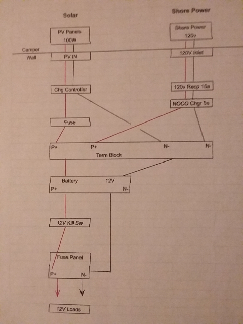

I am working on my son's teardrop and have a related question to the original post. Specifically I want to know if it is OK to wire a NOCO Genius 5a charger output to a terminal block that includes my solar output (after charge controller). I'll be adding a fuse just after the battery, before the fuse panel. The reason for the term block is the battery bank will be a distance from the charge controller and the NOCO charger. Term block does not show the jumpers. Drawing below...

Yes its perfectly fine to take multiple charge sources to the buss bar.

TimC wrote:I am working on my son's teardrop and have a related question to the original post. Specifically I want to know if it is OK to wire a NOCO Genius 5a charger output to a terminal block that includes my solar output (after charge controller). I'll be adding a fuse just after the battery, before the fuse panel. The reason for the term block is the battery bank will be a distance from the charge controller and the NOCO charger. Term block does not show the jumpers.
That's essentially what we do. Our charger is built into a PD 4045, but we can charge from that, or a solar panel via a charge controller, or the tow vehicle. The wiring for the first two is the same as you show. Of course, I don't anticipate more than a single charge source at any given time.

Thanks Scott and Tom. In his teardrop the solar will be disconnected from the system when charging with 120v.

TimC wrote:I am working on my son's teardrop and have a related question to the original post. Specifically I want to know if it is OK to wire a NOCO Genius 5a charger output to a terminal block that includes my solar output (after charge controller). I'll be adding a fuse just after the battery, before the fuse panel. The reason for the term block is the battery bank will be a distance from the charge controller and the NOCO charger. Term block does not show the jumpers. Drawing below...
That’s exactly how I have my NOCO charger wired.

If you have a spare fuse on the fuse block you can also run the solar there. and then when you kill the 12 volt switch it will disconnect it from the battery.

Would you need a switch to turn off the PV panels to the terminal block when you are running shore power? Otherwise, if you are plugged into shore power, then the sun comes up and you have both systems feeding in power. Or is that a problem?

Bezoar wrote:Would you need a switch to turn off the PV panels to the terminal block when you are running shore power? Otherwise, if you are plugged into shore power, then the sun comes up and you have both systems feeding in power. Or is that a problem?
Your solar charge controller and battery charger will not fight against each other or interfere with the other. When the battery gets close to full the charge will decrease as normal and it will be fine.
