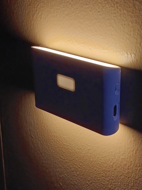

I bought a set of three of these lights that recharge with USB in an hour or two and work well. They have lasted over a month with the original charge on my basement steps. These particular ones communicate with each other with bluetooth (I think), if fairly close by, and are motion activated or can be switched on if dark enough. If I build another TD I'll install some on the teardrop where I want motion activated light. They are not reading lights. They are mostly night lights for navigating after dark. They attach with a magnet to an included "Command Strip" type adhesive on the back of a metal disk you can stick on any surface or without the strip to a metal (ferromagnetic metal) surface.
They are Wyze brand but have been sold out for a while. There are other brands out there...
