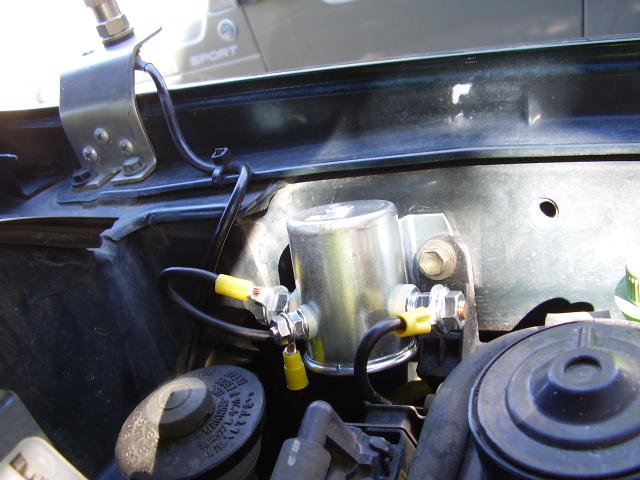

Postby Gerdo » Mon Sep 11, 2006 7:42 pm
I ran my #10 from a constant use solenoid today. Instillation went well. I put a fuse in line.

Postby Gerdo » Fri Sep 15, 2006 4:43 pm
I have A picture. It is my constant use solenoid. I mounted it to the inner fender.

Postby Gerdo » Sun Oct 01, 2006 8:22 pm
On my trip back from thr Colorado Campout this weekend my solenoid seems to have recharged the TD battery. All is good. Before the trip I did add a switch to shut off the power to activate the solenoid. This way I don't charge an already charged battery and I also don't have to listen to it close when I'm not charging.

Postby Gerdo » Fri Oct 06, 2006 9:17 am
The voltage that I read on my TD battery when I got home was 12.8V. After a few minutes it settled down to 12.6V. It seems to work.
