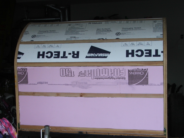

Postby bledsoe3 » Wed Sep 28, 2005 9:15 pm
Mike, as far as which steps it doesn't matter. I am trying to build doors right now. I haven't cut the 3/8 yet. I'm scared. I have insulated. Here's something I did that makes it easier. I used the ridgid foam board on the flat surfaces and the R-tech for the curved surfaces. It bends much easier.
