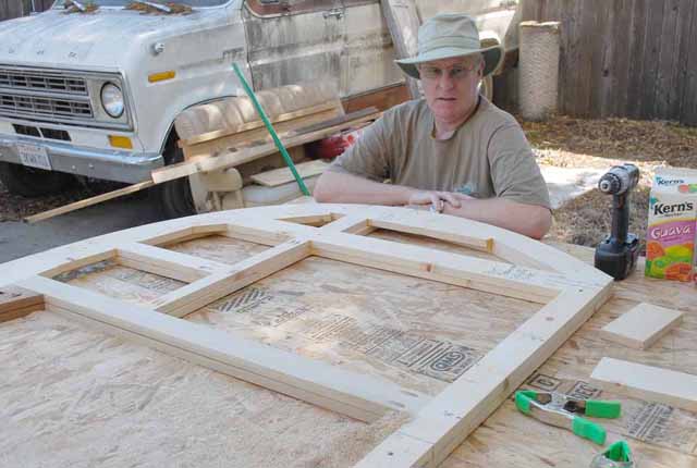

Postby Ron Dickey » Sat Sep 27, 2008 12:22 pm
soea this sound right ??
I want to do my doors as hollow doors with a center core (mine will be square). with insolation in the gaps.
looking kinda like this
pix is of Steve B and his side walls.
then skin them adding insolation before closing top or bottom skin.
thn add windows & door knobs. then add T strips & hinges
8)
Ron D. :thinking:
