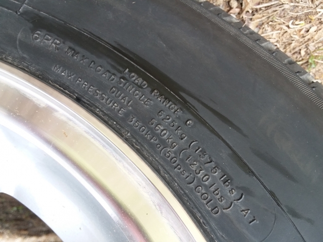

Looking for advice on what I should run pressures at. The single axle trailer is just under 1500# gross. Tires are ST175/80R13 Radials. Tires read max pressure cold of 50 psi.
Added a photo if it helps...
Thanks, Tim
Pmullen503 wrote:With your trailer at it's normal load, drag it through a puddle (or chalk the tires) to see what kind of foot print it leaves. If just the center treads of the tire are shown in the foot print, the pressure is too high. Reduce pressure until most of the tread is shown in the foot print. Theoretically, all of the tread should be visible but I like to run a little more pressure than that. Be aware that worn tires can give skewed results.
TimC wrote:Pmullen503 wrote:With your trailer at it's normal load, drag it through a puddle (or chalk the tires) to see what kind of foot print it leaves. If just the center treads of the tire are shown in the foot print, the pressure is too high. Reduce pressure until most of the tread is shown in the foot print. Theoretically, all of the tread should be visible but I like to run a little more pressure than that. Be aware that worn tires can give skewed results.
Makes a lot of sense Patrick. When I get home tomorrow I'll be looking at this. Seems like a very good way to pressurize my tires for my trailer weight.

Socal Tom wrote:This method works, but there is still a minimum. Use the chart I posted as a guide. It doesn't go below 25 PSI, so I woudln't go below that.
TimC wrote:Socal Tom wrote:This method works, but there is still a minimum. Use the chart I posted as a guide. It doesn't go below 25 PSI, so I woudln't go below that.
I'll take that into consideration. If I'm understanding the chart I can run 50psi up to trailer weight of 2720#. Does that sound correct for a single axle?
If so, for best MPGs I'll compromise somewhere between Patrick's method and full inflation.
