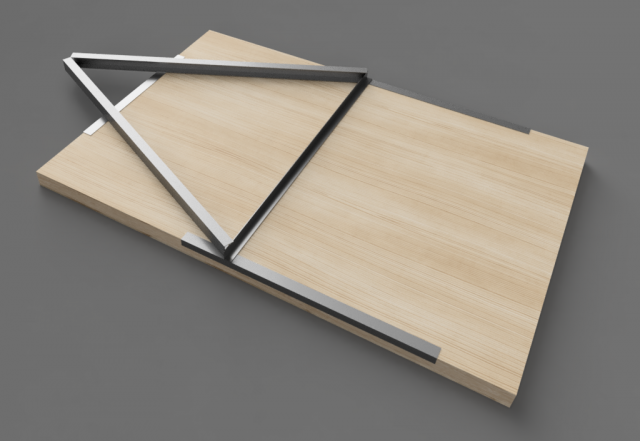

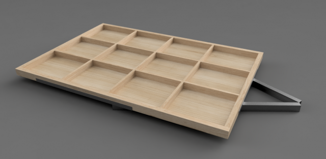

I'm in the design stage of building my trailer. Finding a trailer the dimensions I want for the price I want is proving to be more difficult than I expected. So I'm looking at building my own trailer, however, steel is quite expensive and I think for how much my trailer will weigh I should be ok to build the frame with wood. I'm thinking the weight will be about 450-650# not including the trailer. Have any of you built a wooden trailer or had experience with wood framed trailers?
This is what my trailer design looks like at this point. It has an outer frame of 2x3 beams with 1x3 pieces running across the middle. There is a 1/4" skin on the bottom and a 1/2" floor on the top.

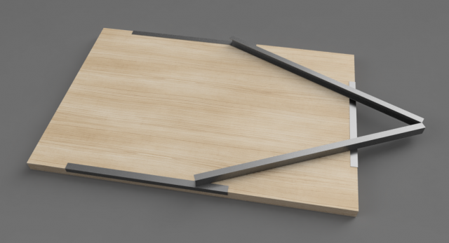

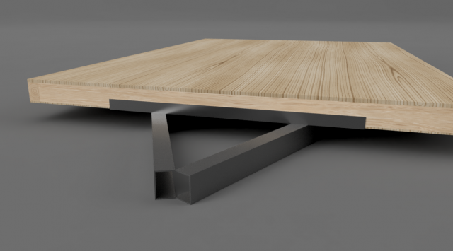

The axle mounting areas are reinforced with 2" x 1 1/2" steel angle pieces. The tongue is two 6' sections of 3" x 3.5# steel C channel. The coupler will be a standard A-frame coupler. The frame also has a piece of the same steel angle reinforcing the front of the frame where the tongue crosses over.
The angle would be bolted to the frame and the C channel would be welded to the angle.
I would cover the underside and sides with PMF to reduce the likelihood of water getting into the frame as I don't want it to rot. The topside would be covered with the actual trailer build which would also be sealed with PMF. I'm probably going to use a leaf-spring suspension system as torsion axles are pretty expensive.
Do you guys see any flaws or problems with this design? I'm not planning on going off-roading with this as I'm towing it with a Honda Civic.

Roger, I agree that wood is not as strong as steel, however, I don't need it to be as strong as steel. I don't need the strength of 2x2 steel tubes, that would be way overbuilding for a trailer that only needs to carry about 500 lbs. I don't see how the frame being wood would cause it to break free from the car either, the tongue and coupler will be steel, if anything the frame will buckle and it'll start dragging on the ground.

The part that I think your frame is missing may be an adequate side to side strength - a solid connection between the axle mounting points from one side to the other. With a torsion axle you get that connection. I would think that leaf springs put more lateral and expansion forces on the points of connection and between them. I would tie the angle iron on the sides together just behind the rear shackle mount with another piece of steel.

I considered this approach when building my TD. I decided it was easier to use a NT aluminum trailer. Most of the weight is in the axle and wheels, the aluminum frame doesn’t add much weight. I did build a torsion box floor. My finished trailer is under 600 pounds and we can easily tow it with a Honda Accord.ImageImage

The coupler will extend the tongue out a bit, but I can also adjust the position of the C channel pieces before they're welded on. I'd like the tongue about as short as I can possibly make it so the aerodynamics are cleaner.
Adding a steel cross member would be fine. However, I could probably just increase the dimensions of the internal pieces of wood to increase the lateral strength. Is this about what you were thinking?

I used 1/4” skins top and bottom. The pink panther foam, glued with foam adhesive to the skins, makes the floor very rigid. You can save weight by using 1/4” skins top and bottom.

I wasn't sure if 1/4" plywood with foam would be strong enough, I'll definitely do that then.
