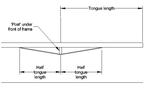

Thanks for your comments. If you have engineering data that supports your concerns, please show me, as I believe my chassis to be properly engineered for my total loaded weight of 500-600#.
The picture in my previous post is my chassis upside down and the cross member is just a temporary brace that's tacked on till I get my Dexter 8 Axle which is the structural rear cross member of the chassis triangle. This design calls for no other cross member.
The The Teardrop body will be a torsion box that's constructed with sandwiched panels that are glued with epoxy and completely covered with fiberglass/epoxy. The torsion box (floor) will be the structural cross member.
My goal is a Teardrop that's 1/2 the weight of the typical 1200# build, hence my lighter chassis design.
Here's a pic of the frame right side up with the tacked on temporary cross member:
Here's a pic of the chassis design. I modified it form Stub axles to a full axle, but the tongue is still 1" X 2" rectangular steel tubing:
