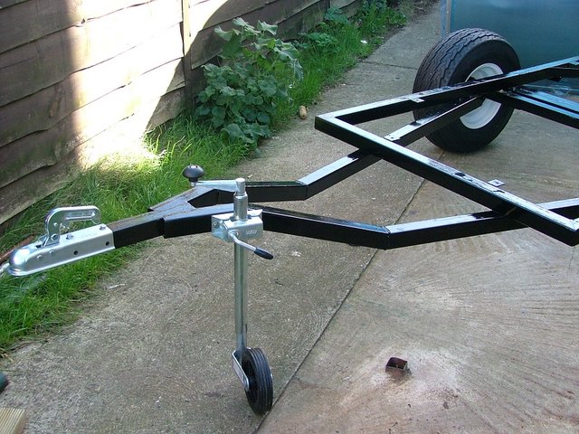

Postby UK-Corlett » Mon Jul 16, 2007 7:59 am
Hi Shoeman
I put a "swan neck" in my tonge. As my TD only weighs in at 320kg, I welded it without the fish plates. Note my tonge has two 2" square tube (14 uk SWG [2mm thk])
I also used a machine saw to get the angles correct.
Ive done approx 1000 miles so far / so good.

Postby madjack » Mon Jul 16, 2007 8:42 am
Clive, how much difference is there in your "swoop"...I like it but would be very leery of using it without the fish plates...but maybe our roads and speeds are much different to what yours are...I do like it though and it is similar to the original KIT frames which had a bent tube tongue like yours....

Postby UK-Corlett » Mon Jul 16, 2007 9:34 am
Madjack
My "swoop" is 150mm (6") in 408mm (16") roughly a 10degree up and then 10 degree level off. The best this is that it look pretty.
My nose weight is only light. I have a small wife and it was important that she could handle it. So its approx 50kg (110 lb).
So if you do the sums and I did the loads are not amplified so much.
I once forgot that it was hooked on and remembered when i got to 80mph. I also gave it a massive jolt the other week when I was not quite straight and zoomed of from a stand still, my tow car is a big Jaguar.
I do check for cracks but non yet.

Postby madjack » Mon Jul 16, 2007 10:32 am
Shoe, a fishplate is basically a gusset that follows along side the profile of a weld...
Clive...thanks for the additional info...just don't power a flip into the trailer with that big ol' Jag.......

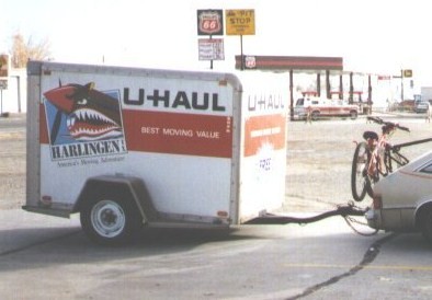

Postby Melvin » Mon Jul 16, 2007 12:06 pm
U-Haul does something similiar, though the curve is on a single tongue not a V:
These trailers get abused something horrible carrying a lot more weight then our tears.

Postby Nitetimes » Mon Jul 16, 2007 1:50 pm
Melvin wrote:U-Haul does something similiar, though the curve is on a single tongue not a V:
Keep in mind that that tongue has been machine bent not cut and welded back together. Makes a big difference in the strength.
