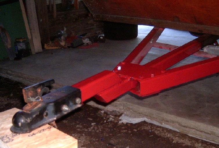

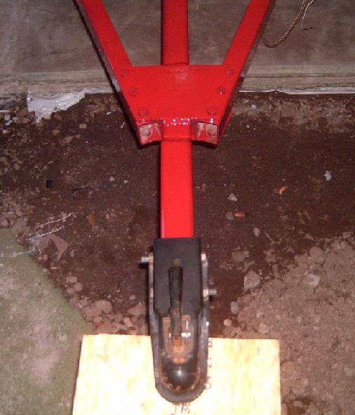

Postby bobhenry » Wed Feb 22, 2017 7:19 am
My Horrible freight needed some lovin' too! Here is the pics of my results........

Postby QueticoBill » Wed Feb 22, 2017 8:35 am
Very similar issues. The center tube - you added it I assume. Is it 2" or 2 1/2". If 2" is the coupler simple designed for that - stock NT is not - or shimmed?
QB
