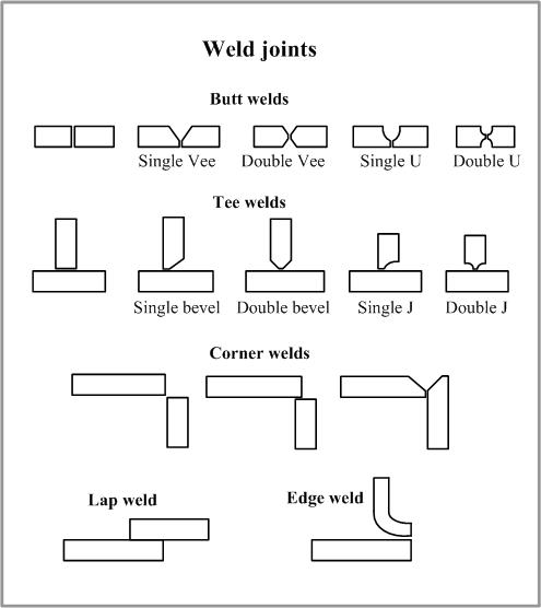

So you want to be a welder? Follow along as I explain the finer points of welding in terms the average do-it yourselfer can understand. I have been a professional welder and fabricator for over 15 years. Certified in structural steel welding in light and heavy gauge, manual and semi automatic processes. Also over a decade of MIG and TIG welding for the aerospace, ultra high vaccume, and motorsports industrys. I've welded bridges, buildings, race cars, aircraft and spacecraft parts, vaccume chambers, trailers and loads of misc. "stuff" over the years. Follow along as I present alot of information, hopefully in a way a beginner can understand.
Learning to weld can be both fun and rewarding. Let’s dive into what the newbie hobbyist welder needs to know to produce strong, safe, preferably good looking welds. In its most basic form, welding is the act of melting two pieces of metal and a filler material, joining them together, all the while protecting the molten metal from contamination from the air. This can be accomplished through several processes available to the hobbyist.
SMAW: Shielded Metal Arc Welding, aka arc welding or stick welding. A hand held clamp, sometimes called a stinger, is used to hold flux coated welding rods. As you weld, the rod burns away melting the base metals and the rod together. The flux coating on the rod is melted and it flows over the molten weld pool, protecting it from the air. The flux hardens over the weld and must be chipped off and wire brushed to remove it.
Pros: Different size and type of rods allows welding many different materials, material thicknesses, and positions. Easy to get good penetration. Can be used outdoors in windy conditions. Machines are relatively cheap and simple, no moving parts. Can weld dirty or rusty material.
Cons: Smokey, some weld splatter, requires chipping and cleaning of flux from welds.
GMAW: Gas Metal Arc Welding, aka MIG (Metal Inert Gas) welding or wire fed welding. With this process, a spool of solid wire is fed through the welding gun by rollers, where it melts on contact with the base metal, fusing them together. A separate bottle of an inert gas, typically a carbon dioxide and argon mix, is piped through the welding gun and covers the molten weld pool, shielding it from the air.
Pros: Easy to learn, no flux to chip and clean, easy to fill gaps in joints with poor fit up.
Cons: Cannot weld in windy conditions, typically only indoors. Moving parts occasionally get jammed; gun liners and tips need to be replaced occasionally. Easy to make a good looking, but weak weld with insufficient penetration. Must have inert gas bottle refilled by a welding shop.
FCAW: Flux Core Arc Welding aka flux core. A combination of MIG and SMAW. The mechanics are the same as a MIG: A spool of wire fed through the gun by rollers. However, instead of a shielding gas from a tank, the welding wire is hollow and flux is inside. Basically, an inside out SMAW rod. Like SMAW, the melted flux provides the shielding action for the molten weld puddle. Most MIG machines can be set up to weld with flux core wire.
Pros: Can be used in windy conditions, easy to get good penetration.
GTAW: Gas Tungsten Arc Welding, aka TIG (Tungsten Inert Gas) or Heliarc welding. This process uses a torch that a replaceable tungsten electrode is inserted after being sharpened to a point. The diameter of the tungsten is typically 1/16” to 1/8” of an inch. Unlike the other processes we have talked about, the tungsten electrode is not consumed while TIG welding. If additional filler metal is required to be added to the molten weld pool, it must be done by hand with a welding rod, similar to gas welding. Like MIG, a bottle of compressed inert gas is used to shield the weld pool. Argon is the typical inert gas of choice for TIG welding steel, stainless steel, and aluminum.
Pros: Clean, splatter free welds. Ability to weld exotic metals such as stainless steel, aluminum, titanium, and magnesium.
Cons: Requires great skill, coordination, and dexterity. You are simultaneously using one foot on a foot petal to control the heat output, one hand to hold the torch to control the electrode angle, arc length, and travel speed, and the other hand to feed in welding rod to the weld pool. Cannot be used in windy conditions, indoors only. Requires material to be extremely clean. Inert gas tanks have to be refilled periodically. Tungsten needs to be sharpened occasionally, or every time you contaminate by dipping it in the weld pool.

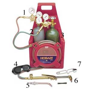

Oxy-Fuel welding aka gas welding. Uses a tank of a fuel, typically acetylene, and a tank of compressed oxygen. The fuel and oxidizer are mixed in the tip of the torch and lit on fire, producing a very hot flame. The flame is used to melt the base metals, and additional filler rod can be added by hand if necessary. Special tips can be installed for cutting steel or heating steel red hot for bending.
Pros: requires no electricity. Ability to cut relatively thick (around ½” for a basic setup) steel. Ability to heat, cut, and weld with one setup.
Cons: Very slow process. Requires skill and coordination similar, but a little easier than TIG welding. Tanks have to be filled periodically. Most hobbyists sets not suitable for welding thick material.

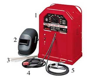

Your typical stick welder. Note it is very simple, a ground clamp, the electrode holder clamp, and a large knob to set the amperage.

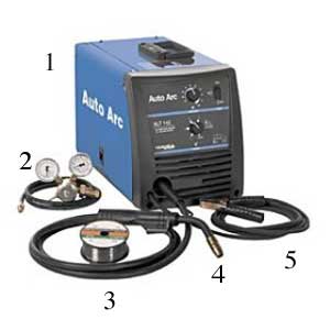

Your typical MIG welder. Note the ground clamp and welding gun that the shielding gas and wire are fed through. Knobs set the amperage and wire speed.
Your typical gas welding setup. Note different tips for welding, cutting, or heating.

3) AC buzz box. The Lincoln 225 “Tombstone” welder is available new for under $250, and can be picked up used for less.

1) 135 or 140 amp mig welder such as the Miller Millermatic 135 or 140, the Hobart Handler 140, or the Lincoln SP-140. For a 1/8” thick trailer frame, I would run flux core wire for better penetration. It can be used as a MIG on 1/8”, the machines limit, with very good joint preparation but only for flat butt welds. These welders will need a 20 amp circuit to run at full power, most typical garage receptacles are 15 amp. If you want to get the full power out of one of the machines, you may need to have an electrician wire you up a 20 amp, 115 volt receptacle. Also, never use extension cords, they will lower the machines output.

MIG:
1) Spool of wire, ER70S-6 for mild steel, .023” diameter for a 115volt machine, .030 or .035” for a 220volt machine.
2) Half a dozen extra contact tips in the correct size for the wire you are using.
3) Pair of mig welding pliers
4) Can of MIG anti-spatter spray, in a 14oz spray can.
5) Leather gloves
6) Welding helmet with #10 or #11 shade lens

SMAW
1) Welding electrodes: E6013 and E6011 in 3/32” diameter. 115volt machines use 1/16” or 5/64” diameter.
2) Chipping hammer and wire brush
3) Welding helmet with #10 or #11 shade lens
4) Heavy leather welding gloves.

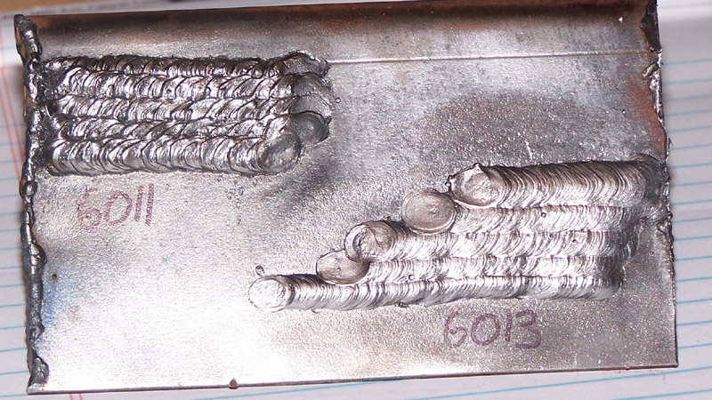

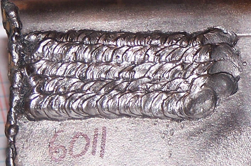

Welding with SMAW

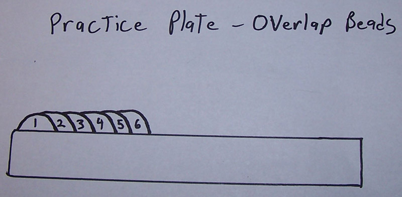

Our first project is going to be a simple flat plate that we are going to start welding on.

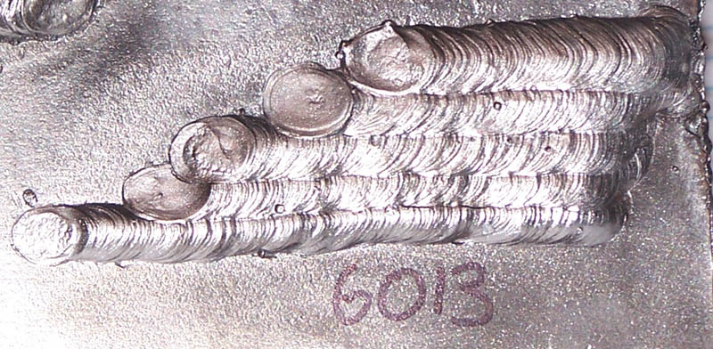

Get yourself a square steel plate; 4”x 4” with a 3/8” thickness is good. The first side we are going to cover with E6013 overlapping stringer beads in the flat position. A stringer bead is a weld bead that is a smooth, straight line, no side to side movement. Just drag the rod across in a straight, smooth, consistent line. The goal is to produce a smooth, straight weld with a consistent height and width. To establish the arc, to strike an arc as is commonly said, you give the tip of the rod a quick scratch on the surface of you joint and quickaly pull away about 1/8" of an inch. If you dont pull away, the rod will stick. If you pull away too far, the arc will extinguish. New rods have the flux coating taper down on the end, exposing the metal rod to allow for striking the arc. If you stop and need to restart with a half burned rod, you will have to break off some of the flux off the end to expose the rod inside. You need a metal on metal contact to strike an arc. Just give the edge of the flux a push with your thumb, it will chip off enough to get an arc established. Arc length should be about 1/16" to 1/8" of an inch, too close and you will extinguish the arc and stick the rod. Too long and you get alot of splatter and a poor weld. After you have laid the first bead down along the top of the plate, we are going to lay another on down next to it, overlapping the first bead by exactly half. Chip and wire brush each weld before starting the next one, never weld over flux. The key points to work on here is learning to lay a straight bead, learning how travel speed affects bead shape and size, and combining all that knowledge to produce a quality weld. Typical beginner mistakes are stringer beads that are curved, blotchy, and inconsistent size. Practice makes perfect: keep your travel speed smooth and consistent, watch the size and shape of the weld puddle and correct if is not what you want. What to watch while stick welding can be tricky. The flux is flowing over and hiding most of the weld. The rod is hiding the direction you are going. All you can see is the weld puddle and the general area above and below it. So that’s what you watch. You need to use your peripheral vision to watch several areas at once. Watch the top and bottom of the puddle to make sure you are traveling in a straight line and that you are getting proper overlap. Watch the overall size of the puddle and keep it consistent by adjusting your travel speed. As you weld, the joint is heating up, the rod start welding hotter as it gets shorter, both contribute to your weld puddle getting hotter and bigger as you go. You have to ALWAYS be correcting your travel speed as the conditions change. Typically you have to speed up slightly as you go. That’s a key point to welding; you don’t lock into a position and speed and hold it there. You constantly change and adapt as the weld demands it. By the time you got the whole side of the plate covered in overlapping stringer beads, you ought to have a feel for what you are trying to accomplish. If not, keep burning rod until you do.
Now, lets move on to the next exercise. Cool you plate down in a bucket of water, and flip it over. We are going to weld the other side with E6011 rod. E6011 is very different from the smooth flowing E6013. E6011 is a noisy, hot, violent rod. It runs very hot, gouges deep into the metal, and likes to throw spatter everywhere. But it’s a great rod when you need deep penetration, or need to weld dirty material such as wrought iron fencing, pipe corrals, plows and whatnot. It also strikes an arc pretty easy and leaves little flux behind; this makes it great for tacking joints together. E6010 rod is nearly identical to E6011 in performance and feel. E6010 is only suitable for welding with DC current; E6011 is DC or AC, that is why I recommended it as you can use it with any welder. If you are welding DC, feel free to use E6010 instead of E6011, its runs slightly smoother and the flux slightly easier to remove but the differences are slight. On to our project. We are again going to cover our plate with overlapping beads; however E6011 requires a very different technique. Unlike E6013 that we simply dragged in a straight line, E6011 rod has to oscillated. The entire time you are welding with E6011, you are moving the rod. There are several techniques and patters, I’ll recommend the two most common: the whip and circles.
The whip is like cracking a whip you fling it forward, the pull it back and repeat. Circles are just that, you move the rod in a circular motion as you travel. Why do we have to keep the rod moving? E6011 is a fast freeze rod that means as soon as you pull the arc away from the weld puddle, it instantly freezes solid. The arc is so hot and violent the puddle won’t cool and freeze if you don’t remove the arc every second or so. So in the whip we hold the rod still in the puddle for a second or so to form a puddle of the size we want, then we quickly whip the rod forward about ¼ or ½” and inch, and immediately bring it back to the weld pool. While the arc was a way, the weld puddle cooled and solidifies. Now that we brought the arc back, again hold it for a second to form a new puddle, overlapping the old puddle by about 80%, and then whip it way again. Think of welding with E6011 as making a series of overlapping weld puddles. Circles achieves the same thing as the whip, you are removing the arc from most of the weld puddle so it can solidify. With circles you move the rod in a tight circular or slightly oval, pattern as you travel. Circles not only gives you the forward/back motion to freeze the puddle, but the up and down heights of your circles can control the width of your weld bead. With E6011 rod, you will get into a rhythm; basically your weld should look like a stack of dimes or poker chips pushed over on their side. As with the E6013, you goal is to lay down a straight, consistent width and height weld. Chip and wire brush each weld between passes, the flux on E6011 is short and difficult to remove, a wire wheel attachment on a small 4 or 4 ½” angle grinder is the hot ticket for removing slag of E6011 welds. Overlap each bead by 50% like the first side of your plate. By the time the plate if full, you should have a pretty good understanding of how E6011 rod runs. The keys to good welds with E6011 is watching the puddles, constant travel speed, and even spacing between your whips or circles.

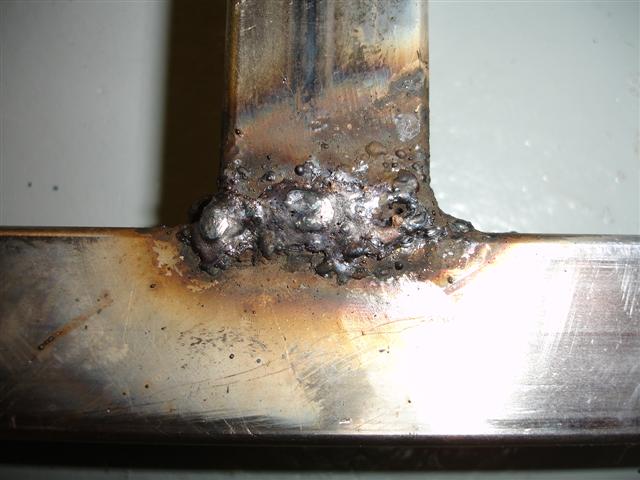

Friends don't let friends weld like this!
