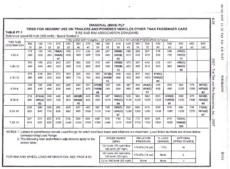

I missed this thread before. There is a Tire and Rim Association Standards guide for load / air pressure for any size tire. Just ask for a copy of the page for your tire size at your favorite tire store.
Clarkbre, your formula is close. For the 5.30B-12" tires I normally run, they are rated at a 855 lb load capacity per at 55 lbs. Based on the rate chart I have for them, I run them at 25 lbs, which gives me a 535 lb load capacity per tire. Using your formula I came up with 34 lbs pressure based on the above info.

Postby schaney » Tue Nov 03, 2009 10:02 am
Here is a older copy of a page from the Tire and Rim Association Standards for load / air pressure. This is the maximum load standard for given air pressures that any tire of the listed size must meet.
So if you know your loaded weight on the axle, just use the chart to look it up, and this is the lowest you can safely run your air pressure. You'll be safe running your air pressure anywhere from there, to the maximum air pressure rating. Never run lower that the recommended air pressure for a given weight, you're asking for problems.
