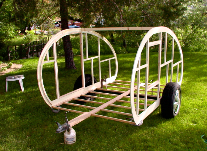

martymcfly wrote:I just bought a 1977 Vanson boat trailer last weekend for $125. The springs, axle, and fenders are all one piece that is bolted to the boat frame with 5 bolts on each side. A set up like this might lend itself to an application like the pic above posted by Alaskan teardrop. The only problem is that it is 72 inches wide.
rowerwet wrote:I worked on aerobatic aircraft for a while, the top performing aircraft at the time were the Extra 300. They used a wooden spar for the wing, wood will stand up to more repeated flexing loads than the same weight in metal. The aircraft could take 6 g's positive or negative, a real strain on the pilot.
The church I'm the caretaker for has only laminated wood arches to support the roof something like 10 layers of 1x4" lumber, beautiful to look at and much stronger than a truss roof.
A frame built of laminated wood could be lighter and stronger than steel. I would have the frame be the outer corners of the walls, then make the tounge a triangular shape with one arm sweeping up from the coupler flowing into the roof. For even more strength a thin plywood Webb tying the triangle frame together also laminated with marine epoxy.
The bottom two legs of the triangle would flow out and back and graft into the laminated frames making up the perimeter of the walls.
This kind of monocoque construction is what you see in air craft and boats.
