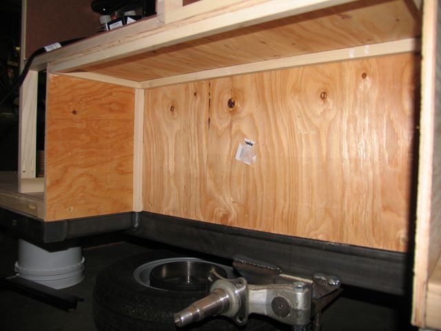

I welded my Flexiride to my 2x3x0.083" frame:

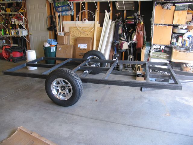

the issue I have seems to be making sure i have room for the wheel and tires.
tony.latham wrote:the issue I have seems to be making sure i have room for the wheel and tires.
I use Dexstar trailer rims without any offset so I probably can't help with whatever offset you have on your rims.
They showed up with 0.75" positive offset
