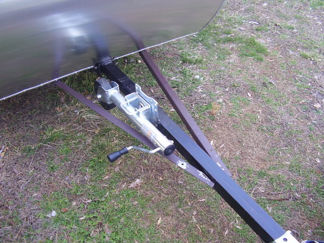

Now on to the trailer,, I will find out tonight if the tongue is flexing due to gremlins in the assembly,, I ran a support angle from 2/3rds the way up the tongue back to the frame under the trailer, and I also attached the angle to the front of the tear box to further tie it all together,,
the tires on the trailer appear to be in good shape but( no bubbles or seperation is visually noticed) however the tires are scheduled for replacement soon,,
the frequency is fairly rapid on the side to side shimmy, but I can still see it,, a follower behind me could not see any shimmy at the rear of the tear,, just the front

Postby Bandit » Wed Mar 01, 2006 5:49 pm
Did you place an angle brace like this? I have not road tested my trailer yet, which probably has no bearing on how it will tow until it is complete.
I added bracing for tongue strength, did not consider the added rigidity.
I also used the V of the angle to route my trailer wires.

Postby Chip » Wed Mar 01, 2006 7:00 pm
Ok,, I spun tires,, I looked at welds, measured again,, tightened up the supports I put on the tongue to try and stablize it,, hooked up the pickle and took her fer a ride,, now I didnt get much past 55 since the door is in the trash pile and I could see the side bow a little from the wind blowing into the cabin,,,
so far so good,,, no shimmy or shake,,, I wont say it is fixed just yet but it looks like it just might,, here is a pic of what the metal supports look like,, no paint yet,,,
let me get a door on and then the real test,,, 75mph plus and if no shimmy then I will be happy,,,,

Postby mikeschn » Wed Mar 01, 2006 8:47 pm
Chip wrote:Image
Nice packaging there Chip...
So are you saying it was the drum surface effect that yu were seeing?

Mike, I think it was a matter of a long flexible tongue coupled with some force or something setting up a shimmy at the front of the trailer,, The additional braces may be treating the symptoms or it may be fixing the problem,, but in any case it seems to have stopped the movement,, I am still going to check other things but at least the Pickle juice wont get shook up now,,

Postby bledsoe3 » Thu Mar 02, 2006 5:20 am
Chip, Does your tongue jack still rotate now?
bledsoe3
Posts: 3694
Images: 112
Location: Oregon, Portland
Postby Chip » Thu Mar 02, 2006 5:37 am
Bledso,, yap it still rotates,, with an 1/8" to spare,,, :thumbsup:
