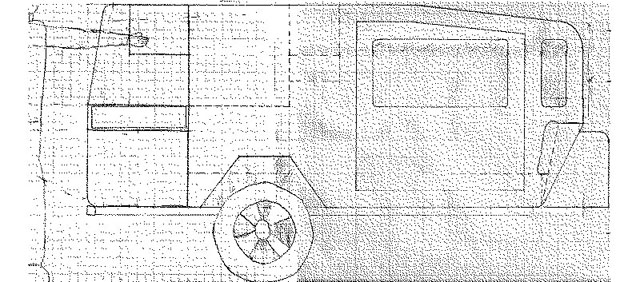

- If you go for wheels-out, it looks to me like it would just work. I've drawn it out below:
(Illustration removed - see correction below)
I've made the width over the brackets 1/4" either side more than your HF frame - this puts the axle bolt holes in the centre of your frame member (which is only 1.5" wide, right? Right?). The 10.25" overhang is the absolute maximum for a Flexiride axle and needs a #9 if you went for a Dexter. The wheel/tyre shown is a 5.30-12 like you have now, but there's room to go up to a 175/80R13 if you want. There is a possible clash with the axle's trailing arm against the sidewall but, if the shaded bit of sidewall is cut out, it fixes that.

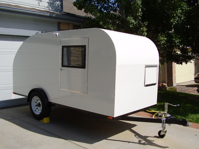

I "Tucked" my wheels in also. I wanted to build 5' wide but didn't want my wheel wider than my tow vehicle. It worked great. I'm glad I did it. The only thing that I gave up with doing this is the usual "Teardrop Fenders".

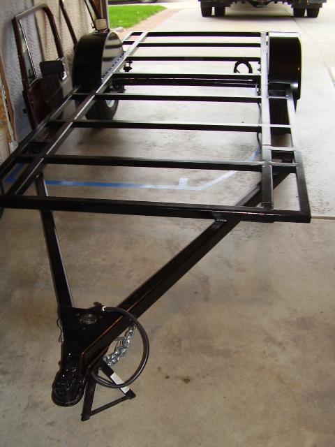

Mine is 5'W x11'L x 4'9"H. It is built over my wheels "tucked". I have 9" of storage under the whole sleeping area. This gives me the same 4' height from the top of the storage to the roof. I tucked my wheels so I could keep my overall width the same as my 4Runner. I also have a 5x10 utility tralier and the wheels stick out so that helped me want to tuck my wheels on my teardrop. I had my frame built and I had "wings" welded on for the wall support.
