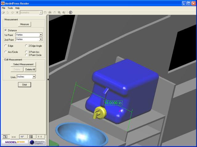

1) This Thread is an attempt to instruct the novice who would like to know
more of how to take measurements and find any dimension for your trailer
CAD design, using modelpress reader.

First we will show you how to install the modelpress reader.
With this tool you will download .wrl files and then use them off line with
the Modelpress reader to get exact measurements of your designed trailer.
A) This is to be downloaded and installed like a program on a Microsoft platform only NOT MAC.
B) Modelpress reader will tell you any dimension you want to know.

Download ModelPress Reader (ModelPress Reader.exe) for PC's, this is the free download
ModelPress Reader review the features
Embedding the MPView Control in Microsoft Office Products
Instillation ModelPress Reader:
After downloading the ModelPress Reader.exe file:
Install the file and reboot the PC
There will be an Icon on the desktop that will be used to open the program
Getting started ModelPress Reader:
Example of how to get started and use the ModelPress Reader:
Download winterwarrior.wrl file to your desktop:
(right click as select "save as")
http://www.mikenchell.com/images/winter ... arrior.wrl
Click on the ModelPress Reader Icon that is on your desktop.
The ModelPress Reader will open.
Click File > Click Open
Find the winterwarrior.wrl that you saved and open that file.
Experiment with Measurements
Example of what you can see and measure:

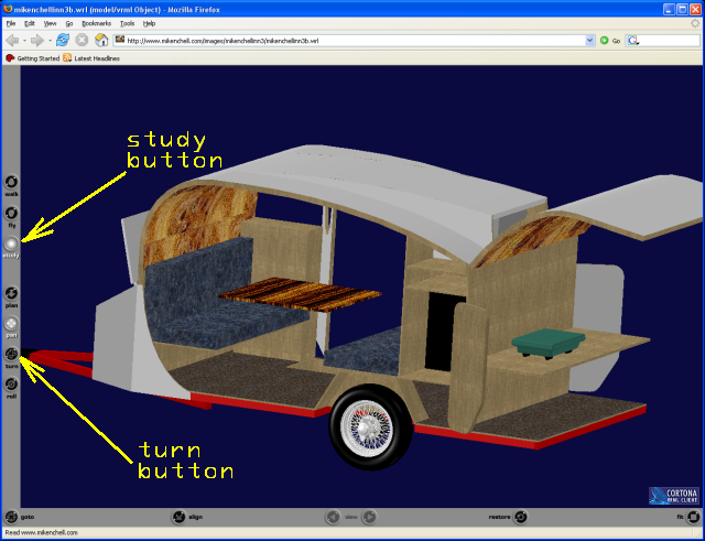

Basic instructions for use of "Cortona" 3D Virtual Reality program
User Guides
After installing Cortona into your browser you will be able to virtually view
the examples below just by clicking on them. The browser will open a view
of the image automatically.
Note: Basic use of Cortona:
Click on the STUDY button
Click on the PAN or TURN buttons for different views
USE your ARROW KEYS on your keyboard to move the image.
