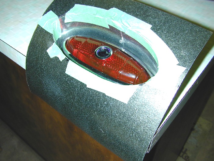

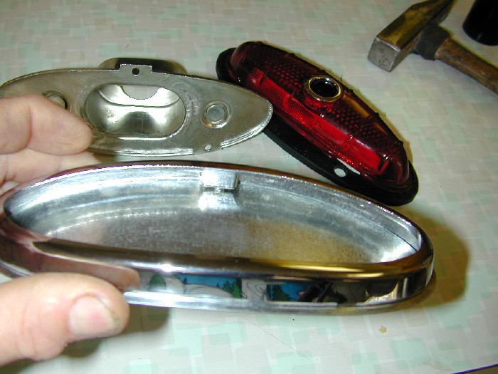

I just finished developing my patterns for the tunneled tail light mounts... got it mocked up in 26 ga. galvy.
These two pics don't really show much, but when I get these tunneled mounts fabbed up in 16 ga. stainless, I think these are gonn be some pretty nice fenders...
