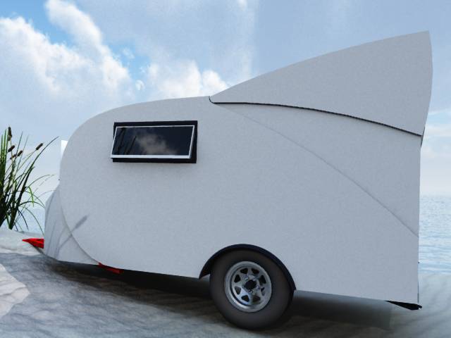

OK Mike, time to come clean! Just what program are you using to create these life like renderings – they are just spectacular inquiring minds want to know
We may not be able to afford it but at least we can drool

For the photos you have shown I used Hypershot and Vue. For the ones you don't have shown, I also use Carrara.
