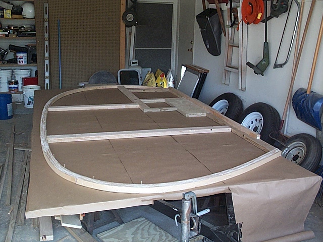

If Qcad will allow you to pick points you can layout the full size without full scale drawings. Draw a 6" grid over your design. Pick each point your design curve intersects the grid and record them. Cover your work bench with kraft paper and lay out a full size 6" grid. Transfer the points you recorded to that grid. Use a spline, a flexible yard stick, strip of flexible thin plywood, etc to connect the dots. I used the floor of the trailer as a work bench. Laid out the inside curve points of my sidewall perimeter, put deck screws in at those points and bent the strips of Luan around them to make a "Glue-Lam". You can't see the grid in the picture. If Q cad can't pick points send me a file (dxf, dwg, igs, many others) and I'll send you back a pdf with that information. Should only take a few minutes to do in Rhino.

You mean something like this?
I think that's what the boat makers call lofting. Thanks for the suggestion.
