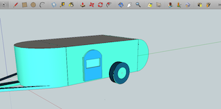

I have the free version of Google Sketch up, and I have created a 3D drawing of the camper I want to build, but I can not figure out how to get the drawing over here to the forum... :thinking: Can someone explain how to do this?

steve smoot wrote:Hi guys,
There are two ways of doing this
1. create a 2d drawing with the export feature under the "File" menu. choose your size to export and it will create a JPG file that you can upload to your album(or photobucket, other picture hosting service) then regular forum picture posting method wrapped in brackets applied
2. upload it to the 3D warehouse, and post link
