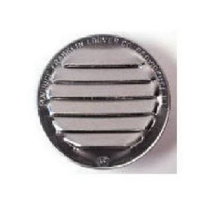

Postby mckenney56 » Tue Mar 13, 2012 11:10 am
bobhenry wrote:Into my 4x7 ultra light trailer I have limited it to 1 door and 2 small windows. I have been looking towards tongue mounted a/c that would be easily removable. I also have been looking at 3 - 4 " pvc duct work as intake and exhaust perhaps natural unpowered ventilation is more of an answer something as simple as a couple floor intakes and a few of these.....
Image [ available in 1 2 and 3" diameter ]
placed high in the sidewall the warm air current would take advantage of thermal lift and would exhaust drawing in more air thru the "floor registers"
What is that vent called when I go to a Lowes or Menards looking for it? And does it have a built in bug screen? And is it cheap?

Postby absolutsnwbrdr » Tue Mar 13, 2012 12:15 pm
I looked at Lowe's and couldn't find anything smaller than a 3" soffit vent. Another member on here pointed me towards this website....
https://ventmastersstore.com/shop/small ... -c-23.html
All sorts of shapes and sizes! Cheap too. Fast shipping as well. :beer:
