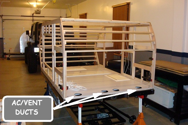

bobhenry wrote:Has anyone else toyed with the idea of floor registers.
I have concidered 4" pvc ducts under the trailer that
protrude thru the floor. These could be used as an
inlet on one side and an outlet on the other powered
by a couple small computer fans. With this set up a
heater or a/c unit could be set up outboard under the
trailer very neatly. This would save space and quiet
down the inside noise level a bit.
