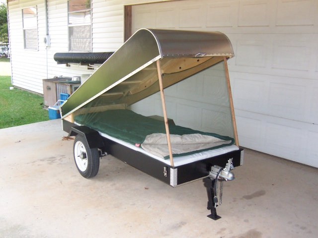

Postby highlandercj-7 » Thu Dec 18, 2008 10:39 am
You may try to find a Apache, Since I bought mine I have found 4. Here's a pic, it's all aluminum. they weigh about 300lbs with out your gear. They are 4 on 4 lug axles so golf kart atv tires would bolt right up.
There's a bed on top the box that sleeps 2 and the tent floor area is 7x7 or so, the entire foot print is 12 x 7 the a 7x7 porch off that.
