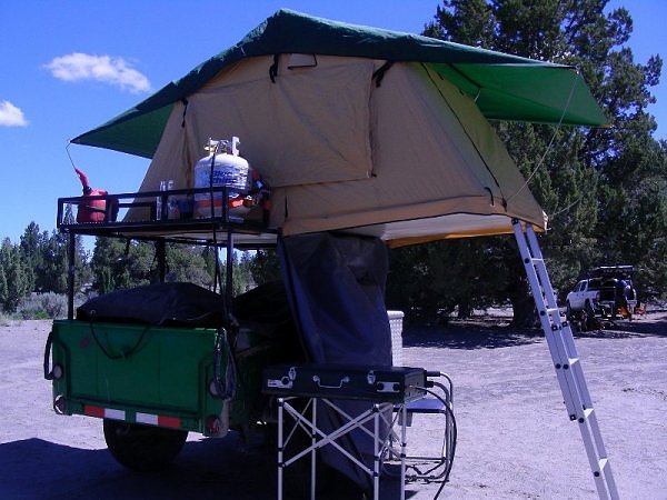

Postby zelix » Wed Feb 02, 2011 9:21 am
So I made a few more mods to the trailer... in case if anyone is following or wondering.
Who doesn't like a nice campfire? I decided I needed to build a firewood box.
the firewood box complete and loaded.
Here's the trailer about ready to roll. I had to get a bigger canvas tarp for the RTT.
My free ice chest barely fits...You can pack some serious food and beverages in there.
New propane holder... I have to work on the tie down system on this
Here it is in use... Some backwoods camping.
