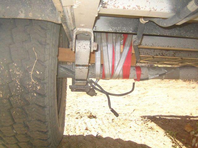

Anyway, this validates my opinion that if I ever broke a leaf spring I could fix it on the trail and drive it home. Which we did, being ever so careful not to stress it any more than absolutely necessary. We even headed for the nearest (and only) paved road and took paved roads all the way home after that.
If you ever need to repair a broken leaf spring, or even a torn frame (another story) here's how. Jack up the trailer a little, so you can jam 1 or 2, maybe 3 pices of 2x4 between the frame and the axle. You want enough wood there so the axle will not travel away from the frame. Then strap it up, all around the frame & axle. Use several straps if you have them. You really don't want this to let go. The "motorcycle straps" with the hooks on them are more difficult to get tight in such a short area, so use a ratchet strap with 1 end free (no hook). Medium duty worked for me. Consider tying a strap from the axle to the front of the trailer to prevent the axle from moving backwards at all.
Oh! This reminds me. I'm REALLY GLAD that our trailer has a frame cross-member exactly above the axle. That has turned out to be important! Or else it would not have been there to tie the axle to! Important 4x4 Frame design tip!
(Actually took this photo the next morning in camp).

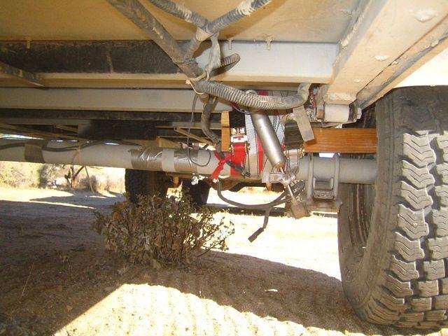

When we got home, I replaced both springs, and saw that the drivers side spring was about to break off too! Just made it! =:-0
Now that I have a new pair of springs, and time to think, I'm wondering if longer leaf springs from a Jeep might work out better. Or better shocks. Or maybe that fancy trailing arm suspension...
Here is the View from the back. Notice the missing leaf spring!
And here is the view from the front:
