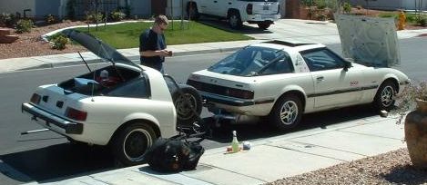

It makes as little - and as much - sense as the trailers built from the back halves of pickup trucks. Probably more than the 1/2 RX-7 I saw today.
An alternative for the braking challenge is to use an ordinary hydraulic surge brake coupler to run the stock Toyota drum brakes. The parking brake lever could be re-mounted on the (new) tongue, for convenience.
For the 4Runner, the transmission and driveshaft hump will be annoying in the interior, the windshield will be vulnerable to rock damage, and some sort of cosmetic cover is needed for the firewall area.
Conversions of whole vehicles to trailers (typically vans) usually suffer from excessive tongue weight because the axle is too far back; omitting body forward of the firewall and putting the galley in the back (classic teardrop balance) might prevent that issue in this case.... oops, we were trying to poke holes in the idea!
The 1/2 RX-7 image is from http://www.rotaryengineillustrated.com/, and apparently belonged to some guy named Blake Qualley.
