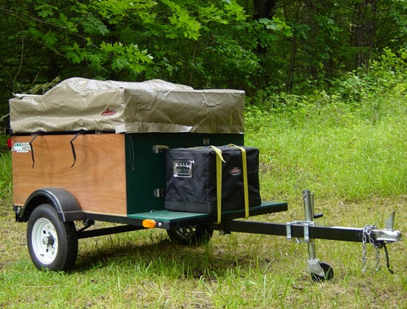

bigalpha wrote:If you were a good fabricator, you could always add another wheel at the tongue of the trailer. Similar to the extra tires big dump trucks have to keep the frame from bending all the way to the road.

Those axles are as close as possible to the main axle and are in a very different situation dynamically than something right under the hitch. Adding a caster wheel under the tongue is a bad plan for control, and if the purpose is to reduce hitch weight then it makes more sense to just balance the trailer properly.
My example used 100 lb of hitch weight; I hope that's the outside limit and the design target would be lower, but even that 100 lb should not be a problem for an Escort to support, any more than the car would have a problem with 120 lb in the middle of the trunk.

bigalpha wrote:... Instead of mounting a whole 'nother axle underneath the rear, why not just one tire that would pivot and turn with the car?
