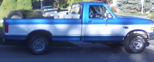

oh and her is the tow rig

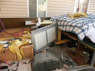

Well i decided to go with a sorta weekender type style trailer with a small cargo space on the front for fire wood generator coolers. i got my parts trailer torn all the way down today and realized just how weak the frame was so i decided it would be smarter to build one instead for trying to strengthen frame but i did get some good parts out of it
also picked up some tires they are 32.5 on 16 inch rims the rims are at linex right now a 3500 pound axel some metal and some wood. i havent done much on it though cause i been finishing my heavy duty front bumper.
