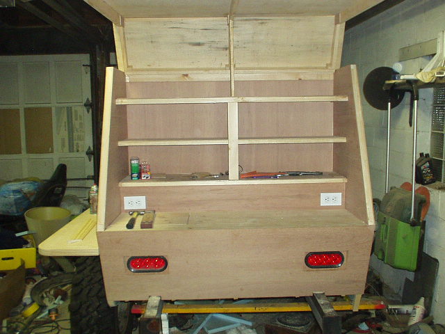

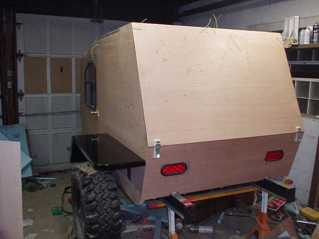

Postby TOTAL CARNAGE » Thu Sep 22, 2011 10:12 pm
Hello all. While I have been working on the camper every night, it has been little detail stuff not worth pics.
I have finished the roof and top front panel. I have the shelf done in back
The face is being made right now. I have to find the track for the sliding doors yet.

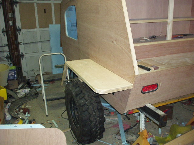

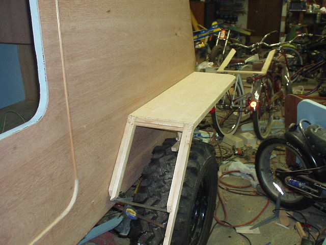

I also started to build my fenders. They are a full 12" wide to cover the 31x11.50 Swampers.
With the fenders being that wide and that flat, I figure two things.....one, They will make for great tables at camp and two, They WILL get ripped off sooner or later.
With the second part in mind, The fenders will be mounted with two shelf brackets each. I drilled holes into the shell and used silicone to glued wood dowles in. They are what the brackets will be screwed into. between the brackets and sealing/glueing the fenders on with more silicone they will be well supported. With any luck they will tear free with little damage to the camper. I'll get more pics of that when it's done.
In the background (of my junk filled garage) you can see part of the cabnet face glued up.
The frame is also started but it's out at the shop so no pics of it yet.

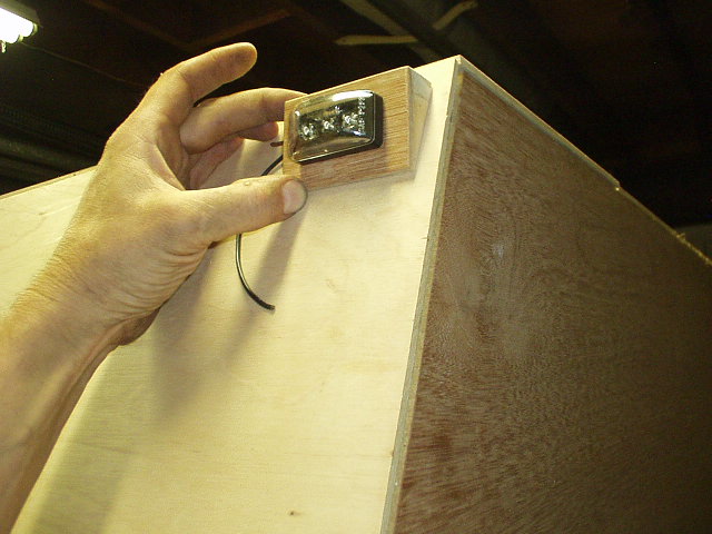

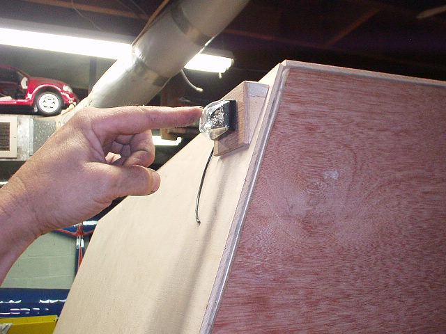

This is one of the little "details" I talked about. Little stand offs for the marker lights.
They will match the frame for the plate and puts the marker light in the same plane as the tail lights.
When you consider that my main wood working tools are a jig saw, drill, plastic mitre box and a 17yo. electric staple gun that will also shoot up to 3/4" brads, it takes a long time to build stuff like this. Well, 9 more to go.........

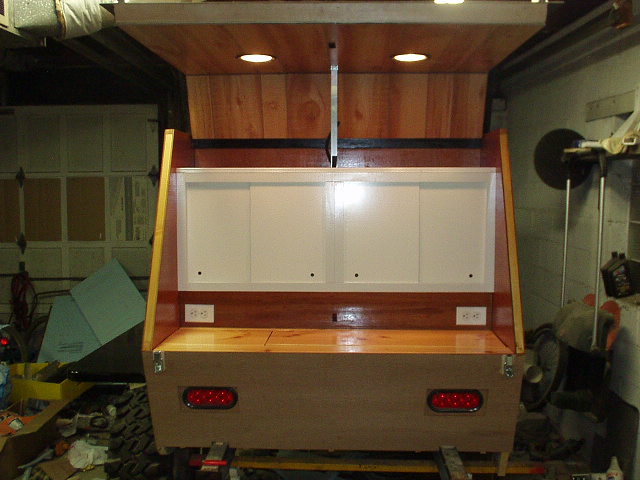

Postby TOTAL CARNAGE » Tue Oct 04, 2011 8:12 pm
Hello all. Thought I forgot about ya, Huh?
Well, truth is, It has been cold and raining for a week here in Pa. and it makes it real hard to get in the mood to do anything but I have done some.
The rear is about done. Staining, sealing and skin the hatch is all I have left. Hatch is waiting on the lights to show up and staining and sealing will all be done at once.
I went with bright white here as it makes a great canvis for future artwork and once the wood is stained, the white frame will make it stand out.
I also started to panel the inside. door and wall.
Has anyone used regular door hardware on their trailer? Like stuff for the front door on your house. I have two matching sets and think they would look good but don't know if they will hold up- down the road. :thinking:

Postby jss06 » Tue Oct 04, 2011 8:57 pm
It depends on the thickness of the walls/doors. If they are standard door thickness then it should work.
They last a long time on ourside use so should be pretty reliable.

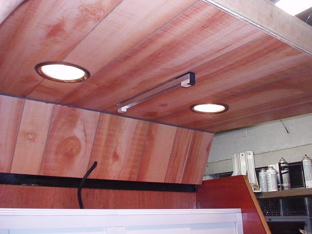

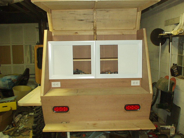

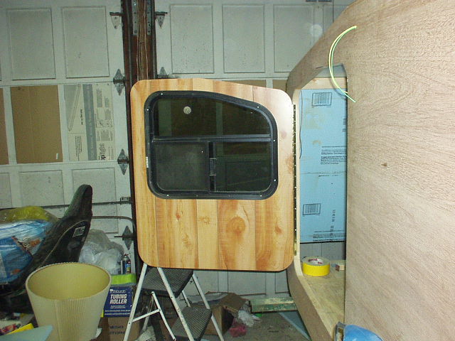

Postby TOTAL CARNAGE » Tue Nov 08, 2011 11:05 pm
Hello all. Still here, still building. Seems to be going slower than I hoped but just jumping in with a bunch of ideas and no real plan has caused some rethinking and redoing. The big chunky frames in the galley are gone.
Replaced with a much lighter, cleaner looking frame.

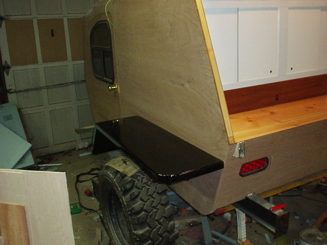

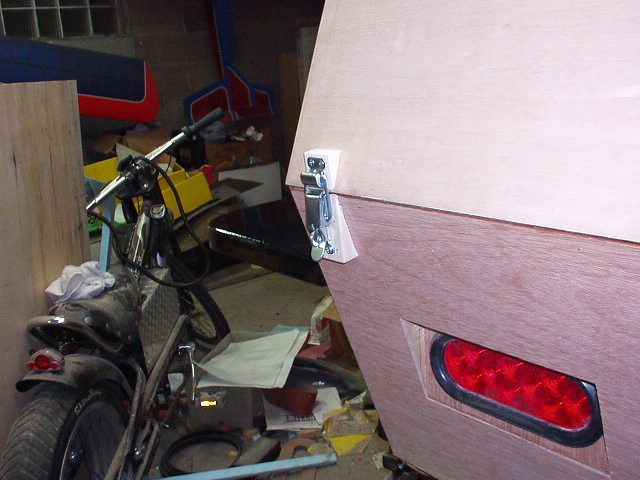

Well, the galley is done. Wired the hatch for the markers and lighting, skinned the inside (NOTE: make sure your hatch is on a flat surface when you put the inside skin on ! ) Seems I built a slight warp into mine. Oh well, took some doing but all better now.......
Just a single prop in the center seems to be more than enough support. Tucks up for storage and hangs right where it needs to be when open. Even if a big gust of wind did manage to lift the hatch, the prop would come straight back down to the proper place.
I think it's looking cool!
Close up of the "Hatch-Latch" lol.....
The fender came out nice! It's a ply/foam sandwich just like the walls.

Almost forgot!! I went with plain old door hardware.....I think it looks out of place and may black them out but I am going to wait and see how they look after the outside is stained and sealed

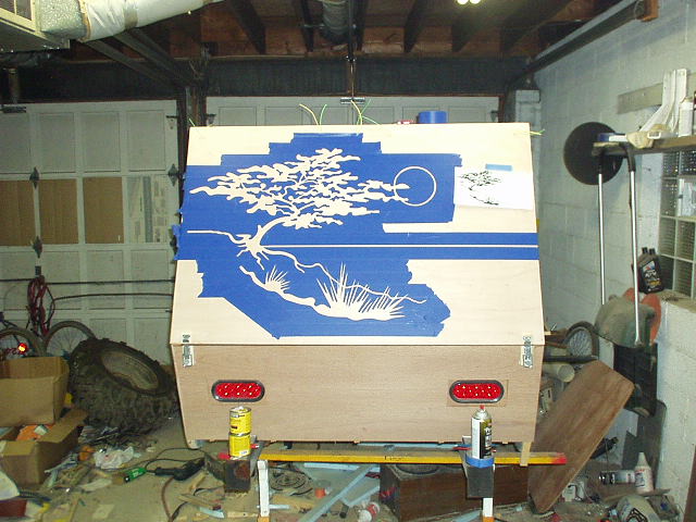

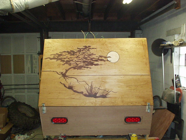

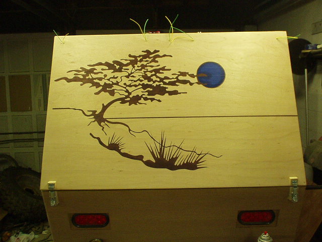

A few nights ago I just didn't feel like doing anything constructive so I decided to do a little art work.
Now, art to me is sitting at my drafting table and drawing up a new toy or getting out the air brush for some paint work so stain and wood are not something I normally deal with. The added pressure of knowing if I screw it up, I'm building a new hatch didn't help.........
I had this pic saved for a long time and thought it would be perfect so I printed it on drafting paper, covered the hatch with tape and drew it out.
After what seemed like hours with a razor blade and some red mahogany stain I had this
I would have done it free hand but with testing found that a brush made the stain bleed along the grain of the wood and wouldn't give a nice clean line.
First step done. I used a rag and just kind of "blotted" the stain on very dry and coat after coat until it was dark enough.
Next, background stain. I tried to make it lighter at the horizon and to look like a reflection in the water.......
Looks very cool in the pics but looks spotty to me in real life. wood just isn't a "consistent" canvas. Oh well, I'm sure it will look good after the clear coat.
watdaya think?...................
