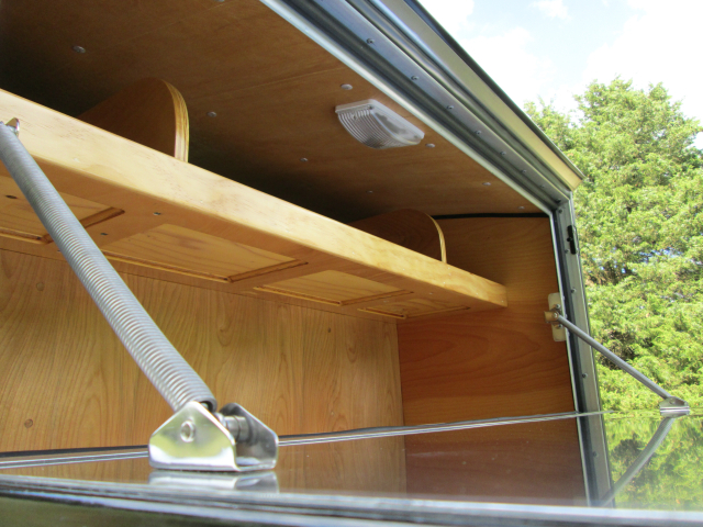

I was just looking through your build log, and it looks like you used a rubber trim attached at the corners for all your trim, if you were doing it again would you still do it this way or just use a "normal" aluminum trailer trim?
Also I was noticing your hatch in your pictures it looks like you just attached an angle around the edges on all sides and then put a rubber gasket on that for the hatch to close to? That is how I was planning on doing mine; and was curious how that worked out for you?

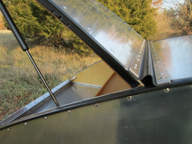

Yes, I've used it on all my trailers. The Alaska TD above is nine years old & spent two years outside at temperatures down to -40* and up to 110* since. Still like new. If you use it, I'd put it on before painting. It can be masked or painted over. It has a 3M adhesive like VHB tape. Note that because the outside flange is short the side aluminum has to be right up flush with the top.
Link: http://www.trimlok.com/prod/Lip-Guard/P ... rd_82.aspx
Unfortunately for the one time builder, Trim-Loc only sells JLGB direct in 250' lengths & I don't have much left. So, the thing to do is ask them for any of their customers who sell by the foot.
Yes, it's 1-1/2"x1/8" angle attached with VHB & rivets. I'm very happy with it. No leaks & closes like a Mercedes door. The seal is on the jamb because the tailgate is used for cooking. On Stacie's back door the seal is on the door so that it doesn't get damaged by traffic. I'd do a hatch that way too.
