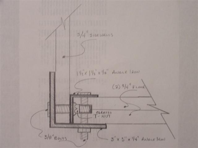

Postby Claw » Tue Nov 28, 2006 10:34 pm
Mitch
The pic above shows roughly how I did my frame. My torsion axle bolts through the 3x3 angle and through the cabin floor. I ran 1 1/2 angle x 1/4"cross members every 2 feet with the axle being the third cross member back. Make sure you have enough tongue weight. You want a strong tow bar and pay attention to how you attach it as this is the greatest stress point. I have a 7' 2x2 x1/8wall square tube as a tow bar, bolted to two cross members and two supports running at an angle from the 3x3 frame to keep it staight. Use quality heat treated bolts, mine are 3/8", I painted mine tight but you could also use lock tight or nylon lock nuts
It has performed well running the gravel roads that follow the levees along the Mississippi. I would trust it anywhere.
