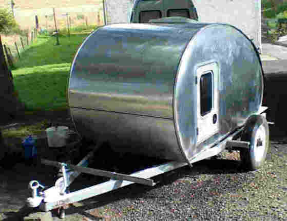

My tear built from July - Aug and into Sep..... :oops:

Postby Mike C. » Fri Aug 24, 2007 3:15 pm
Welcome biz,
Whoooeee that's one nice trailer. Hope you enjoy the forum. Maybe we can ask you questions. :) Looks like you've got it down. :applause:
Relax and enjoy, :thumbsup:
Uncle M ( Mike )

Postby biz » Fri Aug 24, 2007 3:17 pm
Never saw one until a couple of months ago through this site. Thought , that looks easy... :thinking:
Not quite. I had an old trailer lyong around, so thought give it a go.

Postby Mike C. » Fri Aug 24, 2007 3:31 pm
Well you can't tell it. You did a really nice job. One slick looking trailer. :applause: :applause: :applause:

Postby SamR » Fri Aug 24, 2007 3:56 pm
looks nice. Thanks for sharing.

Postby Miriam C. » Fri Aug 24, 2007 8:57 pm
To the playground biz. Can't think of a better use of a perfectly good trailer. Great job. :thumbsup: :applause: :applause: :applause:

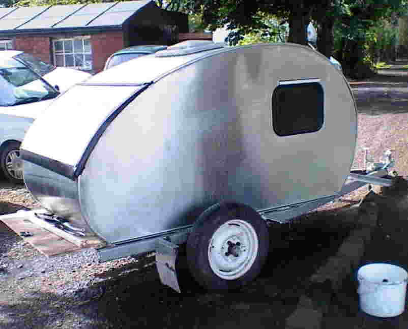

Postby biz » Sun Aug 26, 2007 9:50 am
Will post more pics , once I sort out the gremlins in my software!!!
The profile I used is the ultra-light from the design library - thanks to whoever did that profile and measurements. After that it was design as I go :thinking:
My main worry was where I would get aluminium sheet here in Scotland. Fortunately the place was just along the road. 8'x4' sheet of 0.7mm (I think) was about £20 UK a sheet. I bought 4 sheets. Real problem was getting ply for the roof and ceiling . Bought 4mm from local B&Q (DIY superstore here) and it bent beutifully in the inner ceiling. The I stuck a few srews in at important places and it cracked everywhere like glass :x :x :x . So have used hardboard throughout. Did the job, just needed sealed. Anyway I'll post some more pics soon. Thanks for the help - an invaluable reference guide and it's free. :thumbsup:

Postby biz » Sun Aug 26, 2007 9:53 am
Incidentally, my cost of build so far to get to this stage (interior still required finishing) is about £200. Trailer was £2 at a farm auction. Door and frame was free from an old caravan. Just goes to show, theres no need to spend oodles of cash. :D

Postby Sam I am » Sun Aug 26, 2007 9:20 pm
Very nice, Biz! I admire anyone who can design and build a teardrop without spending a fortune on it!
