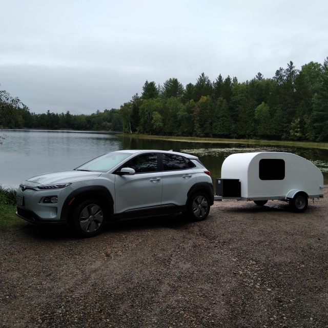

Different EV (which a deer took care of in October) towing the new foamie 4x8...

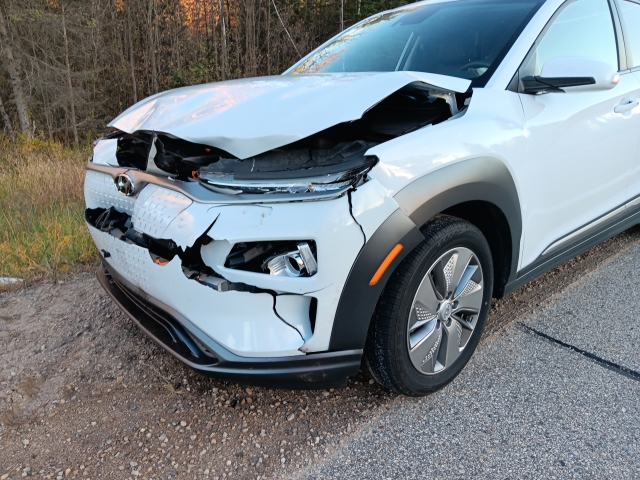

After the deer...

Ouch looks like it is / was a22 kona. I just took my sister to a dealer and she put a deposit on a 24 kona ev today. I had a deposit on an ioniq 5 last spring but the delivery date kept getting moved back and a nissan ariya came available so we bought it. I would be very interested in your range towing. I have heard a third lost but hoping not that much. Your design looks a lot like what I'm planning. I like the look of the curve on the front bottom but just takes away too much room and I'm 6 5. Thanks for the reply and advice.

'21 Kona. Only 18k miles on it when that deer decided to run in front of three oncoming cars traveling south and me going north. I was blinded by the oncoming lights enough to be looking down at the white line on the right side of the road and bang. I dont know how the lead southbound car missed it. My first deer in 47 years of driving. The air bag hit me. I felt it for sure. It knocked the wind out of me but wasn't painful as some folks have experienced. I rolled to a stop on the shoulder just barely off the road and that was that. No ignition. Luckily the hazard flashers worked until the county cop arrived then everything went dead.
I really liked that car. Somebody has a great 62kW battery pack with a lot of years left on it to power their home. I couldn't find a reasonably priced replacement so began considering other models. The ID.4 has about 25 more range miles, is more comfy, quieter and is easier to keep warm in the winter. Towing capacity is about 2k lbs. It's a RWD model.
