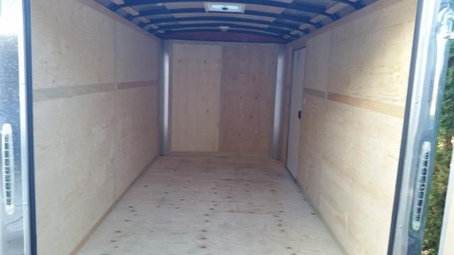

I leave you with two pictures, a before and after in one grouping. The first one was taken the day we took delivery of the trailer from the lot, and the second is the trailer fully completed. Like others have said, you are not really ever done, but given that everything worked as expected during our first outing, I think the changes from this point forward will be refinements, so are unlikely to be noticed by the casual observer. Thanks to everyone for all the guidance while I plowed through this project.
