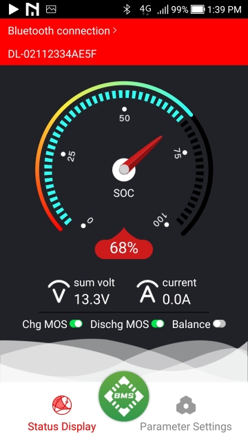

Figured out what was happening with BMS. They send no instructions, but I was able to activate it by hooking up a charger to it ( thanks Google search) Bluetooth then came up and I could see a low temp fault. BmS thought it was at -40c. I was able to spoof the thermocouple input with a resistor and all came alive. I assumed the thermocouple was on the board and the input is not labeled. Chinese seller did not send thermocouple..
In any case, I asked them to send that. This BMS is nice with all parameters available on smartphone app.
Now I can built the cells into case, install shunt and capacity test.

bdosborn wrote:Did you get the Bluetooth dongle to work? I bought a 30A Daly Smart BMS and was threw it in the spare parts box after I couldn't get the Bluetooth to work.
I did get it to work.With all sense lines connected to battery, you have to put a charger on the P- input with B- on battery - to activate apparently.. but nothing like that in the instructions they sent which are very poor. Since my batteries were top balanced, the 14.4 volts on lab supply was not enough difference to activate, so I ramped up to 14.8V and all of a sudden, everything came alive.. then I could see the low temperature faults . That put me on to figuring out what the unlabeled connectors were for.
Did you activate and still not have any Bluetooth?
I ordered another BMS assuming this one was bad and it would take weeks to haggle with supplier. Ordered from another supplier and will still take a few weeks to get from China. In this case, I will have a spare or possibly build another 280aH battery if I find a screaming good deal on cells.

Re: Flboy - Custom 6x12 Off-Road Toy Hauler Conversion
Postby bdosborn » Sat Apr 17, 2021 1:06 pm
Doh, I didn't try charging through it! I'll get mine out of the parts pile and give it a shot. Thanks for the 411!
Posts: 5503
Images: 777
Postby bdosborn » Sat Apr 17, 2021 1:50 pm
Success! Damn, I almost $h!tcanned it, I was so disgusted with it. Thanks for the tip! :thumbsup:

Postby flboy » Sat Apr 17, 2021 3:29 pm
Glad the tip helped. That was my problem. I couldn't get BT to come up and tell me what was wrong. Once I figured that out, I could see the problem and fixed it. In any case, here is the finished product. 280aH in a group 27 case. Going to capacity test it later today. I already suspect the positive lead will need to be replaced with same gage as BMS lead. It appears to be slightly smaller.
