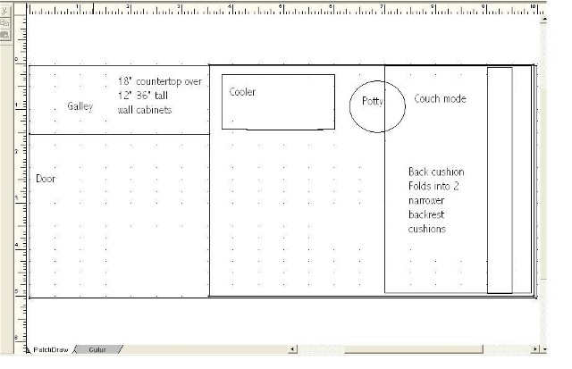

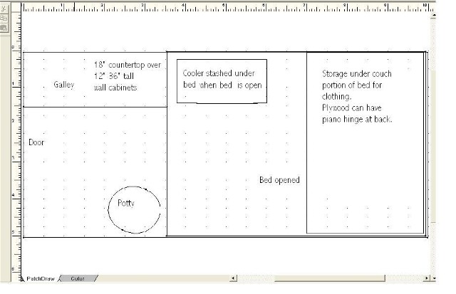

Once these issues are sorted out I would like to decide on a floor plan. I would however, like any fixtures inside to be easily removed as I would like the option of using it as a cargo trailer occasionally.
Anyone here have any sources for windows? Pros/cons of different types? Sizes? Costs?
I plan to eventually build a sofa frame that converts to a bed with storage underneath. Also, some cabinets, closet, counter/table top, minimal electrical wiring & lighting, etc. and storage cabinet for a porta potty.
I don't have a big need of a galley. Maybe a small counter top, small sink/basin, and possibly a set up for a small microwave. I don't plan on doing dedicated camping in it. Just sleeping and changing quarters for my biking/hiking/kayaking treks and travel to and from. I have a really nice Coleman/Fleetwood pop up camper for dedicated camping trips with the family.
Anyone know of floor plans for such a small footprint? I've been searching the web but have not found much.
