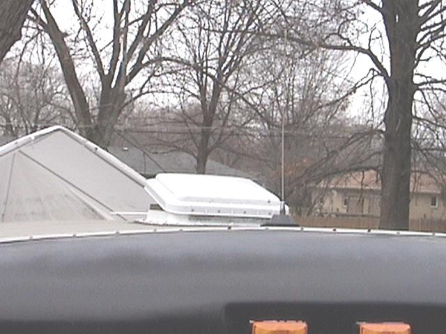

Postby sladezero » Sun Mar 16, 2008 10:05 pm
Hey Nitrox,

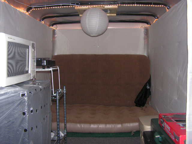

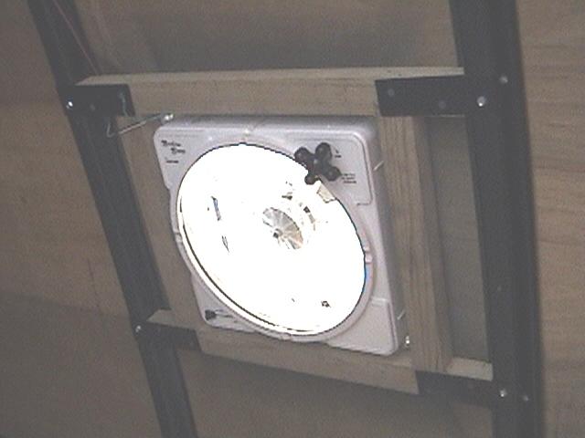

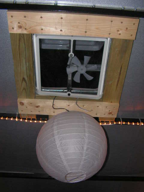

Enclosed are pics of the fan install. I have to fix the alignment a little and hook-up the power. Other than that it is camper ready minus the TV being put in. Also, that is not a disco ball. It is a hanging lamp. I felt this gave a better camping feel to the trailer.

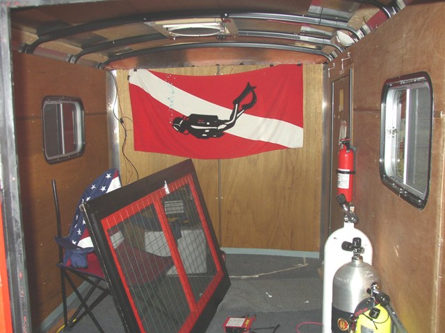

Finally, here is what everything looks like from the back opened.

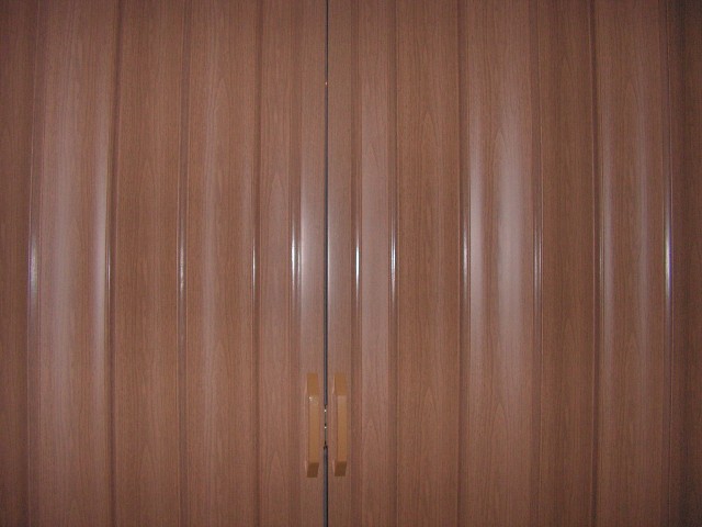

These are my sliding rear doors. They help for ventilation since I do not have a side door yet.
This should help for everyone to visualize.

Postby brian_bp » Tue Mar 18, 2008 6:40 pm
I'm not sure if the vent needs a frame structurally, but the more advanced fan-equipped vents of the same 14" size (such as the MaxxFan and the classic Fantastic Vent fans) need substantial roof thickness for the trim to mount properly.
To mount a MaxxFan in the 1/8" fiberglass roof of my Boler travel trailer I added a two-layer plywood frame on the inside; even the stock traditional vent in the same opening had a single layer of plywood framing, although perhaps only to receive the mounting screws. The fiberglass is likely substantially stiffer than aluminum roof sheeting (it doesn't need the support ribs).
I think that the frame was a good idea: an upgrade later to a MaxxFan or similar will be easily if desired later.
